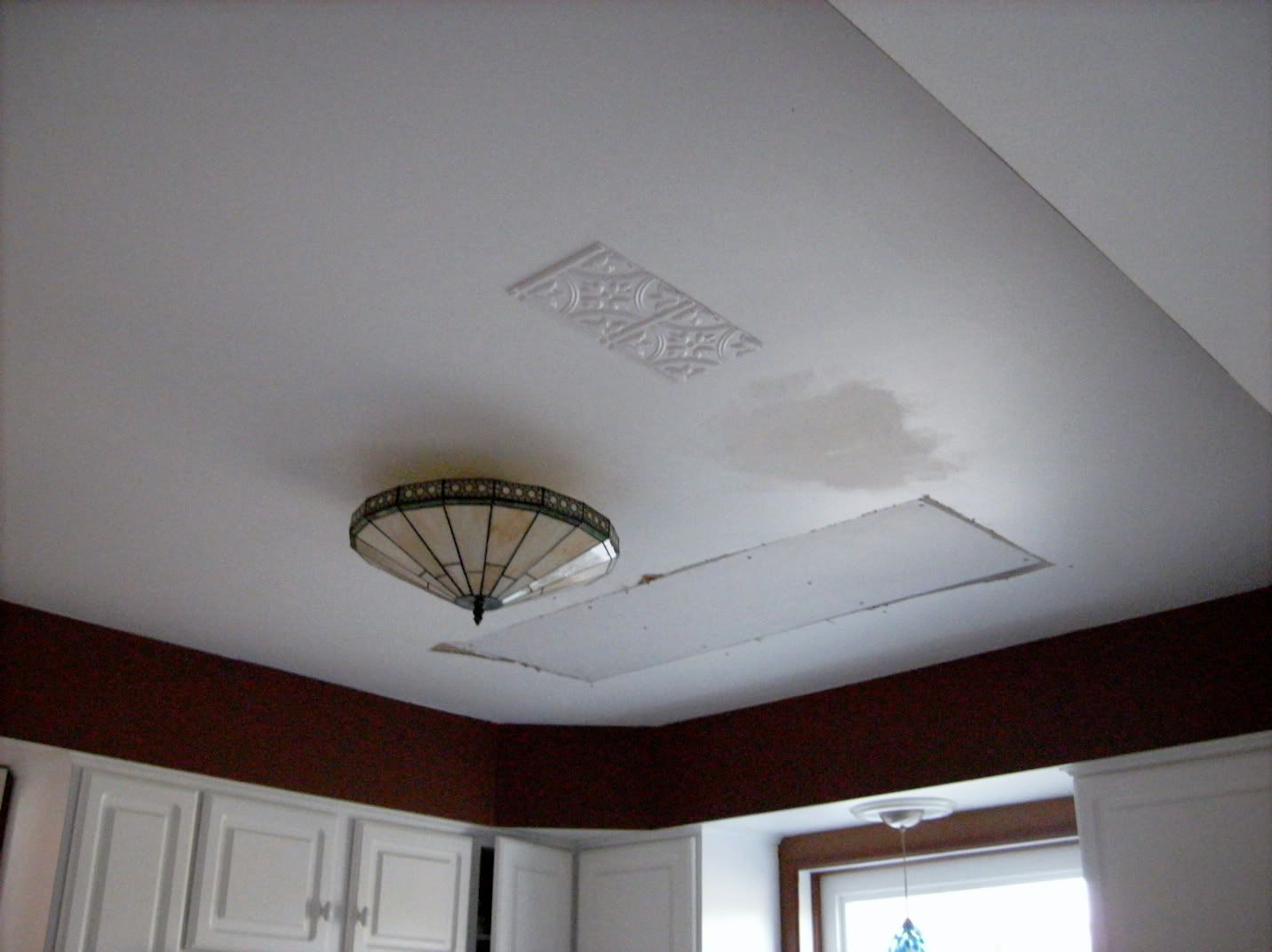

Here's what I ended up with. Just did rough drywall to fill in the area I cut out for the leak. Styrene "Tin" panels adhered with LocTite quick grab adhesive. Did a few nails at the corners where 4 panels meet. This was super super easy and done in about 2 hours. Total cost $200.00.
This is unpainted, next room will try painting.
BEFORE
AFTER
