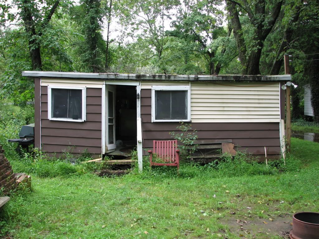

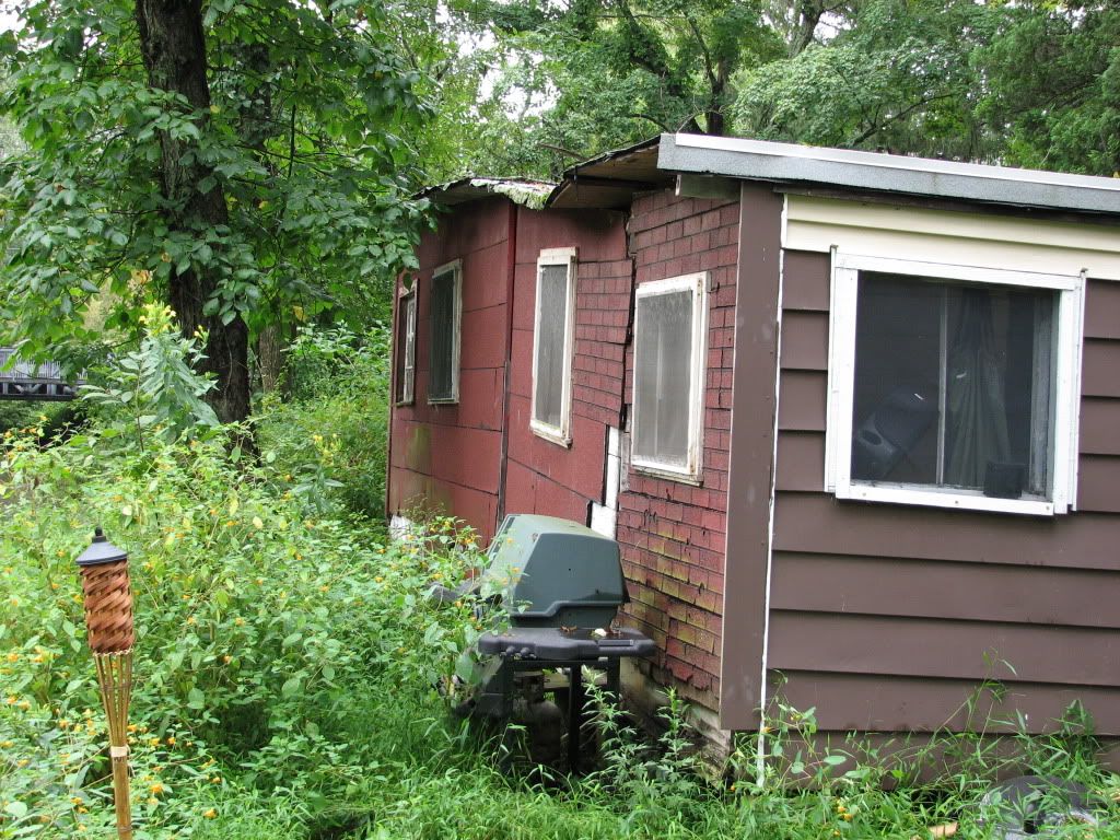

well it looks as if i can pretty much kiss sealing this thing up anytime soon. It needs ALOT of work before then. Most of the concrete pillars holding the cabin up are in decent shape, but due to the leaky roof and the ocassional flood the sills are shot. Looks like ill be learning how to brace this thing up so i can replace the sills before i get into any other kind of work.
I now understand the attachment and the sentimental value.

Just a couple of thoughts. The flatter the roof the trickier getting it water tight. (Real roofers will probably disagree.) I would considerer putting a real gabled roof. You could use pre made gable trusses to speed up the process.
The second thing I would do is jack it up about four feet. Not as hard as it sounds. You have already said it is rotting underneath so slide a couple of beams underneath to take the weight of the joists and jack it up. You can then easily replace the rotted sills then lower it on to a new higher foundation.

Since you have to jack it up some, I'd try to gain every inch you can. I too would be leary of jacking it up several feet but inches are doable and you really need the whole thing level before you attempt much in the way of repairs. Is it feasable to build up the ground between the cabin and the creek to help keep the water away?
I didn't see a power meter so I assume it's away from the structure. It would be wise to have the power off for some of the work and if you can throw a breaker below the meter, maybe install a weather proof receptacle near the meter, it would make it safer.
One thing's for sure, once you are done with this job, you will have gained a lot of constuction skills and bragging rights to show off whenever anyone comes around

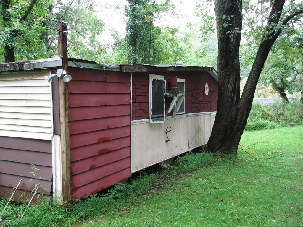

I could think about raising it i guess, but i really dont know how i would go about raising the pillars its sitting on. Im a little afriad of raising this thing even a few inches, as from what i have read i have to hold the cabin from the rafters to replace the sills, and i doubt they are built too well anyway. I tihnk if i was doing a pemanent raise i would feel more comfortable jacking up the new sills instead of the wobbly rafters no?
As far as the electric goes i have no clue .. theres one main wire comming off the house up the hill about 100 feet... it then runs to 3 other cabins befor it ends at mine. Old school make shift stuff. One thing at a time i guess.
As far as holding back the water i dont see any real way of doing that... Its so close to the creek as you can see i cant see building a wall really. Maybe its possible but someone far more knowing then me would have to engineer it . LOL .

I've never attempted anything to the extent that you need to with this cabin but I would think that you would raise the structure by either jacking up off of the next floor joist rather than from the rafters. I would think that would pull the cabin apart
How are the 'pillars' constructed? Are they poured concrete? or block? How is the floor framing attached? By adding onto the pillar with mortar and brick or using wood, you should be able to raise the structure 2"-8" Not much but sometimes every little bit helps.
IMO you need to start out with a level structure. If the floor is unenven it would be difficult to get the rest of the framing evenly repaired - it would be hard to make everything plumb and square....... but I am just a painter

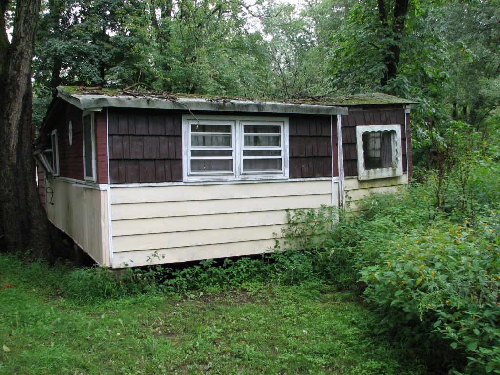

You need to run two or more temporary beams perpendicular to the floor joists. Permissible span of the floor joists determines how many but I would say not more then three in this case.. Any add on section with joists at 90° must have separate beams. Beams are placed two feet in from the sills so they are easy to work on. The siding must be removed to expose the sills.
Jacks are placed under the ends of the beams. Here houses are not fastened to the support piers but if yours are they must be released. The house is jacked very slowly each jack being raised just a bit each time. You can probably get no more the 6" before the lift beams need to be temporarily blocked and jacks sett on top of blocks to raise it more.
From the looks of it you are going to have to either tunnel under or remove parts of the floor to gain access underneath. Here they usually tunnel but much safer to go through the floor for access. You don't want to be under an unstable load.
Better yet and much safer call a house mover and have them jack it up.. Remember any pipes will have to be disconnected first. Same goes for wiring. Here they have companies that level housed but if the ones in your area are like the ones here they don't have the equipment to raise a house, house movers do.
Getting that house up off the ground so it isn't always setting in "wet" in my opinion will do a lot to stop rott and insect damage.

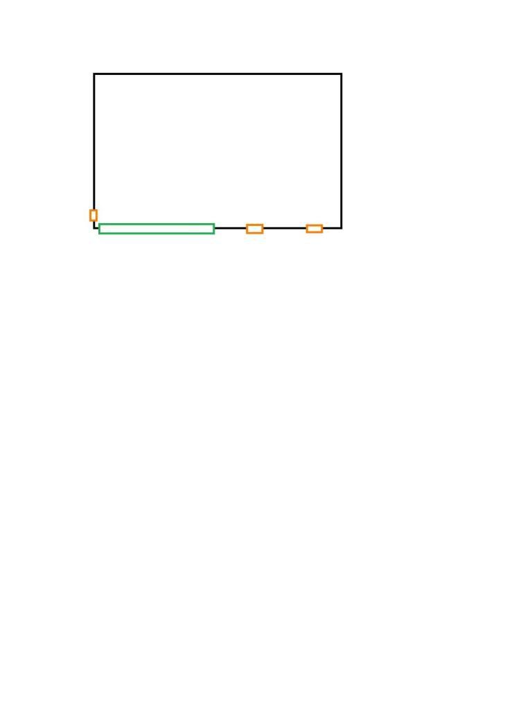

Join Date: Aug 2009
Posts: 24
Received 0 Upvotes
^^^ I dont mean to be a pain in the ass, i know im a newbie and i thank you for your help but i think im still missing the big picture.
Ok, i understand jacking the joists up to suport them and move them up with the cabin. But i still need to jack in other spots to actualy lift up the cabin correct? If im taking the sill out, i cant only jack from the joists, i have to jack from other sills positions that im not removing?
In example, i could jack at the corner on the perpendicular sill, and on the other half of the sill im replacing if i do 1/2 the length at a time.
Heres a picture... the green being the sill section to be removed. Would jacking up the sills on the orange spots be a good way to lift that side and remove the section, while suporting the floor joists, or am i just really misunderstanding the concept?
Just what are the dimensions in this "house"?
If all your floor joists run the same direction then with two beams, we are talking 6 X 12 or so beams here, place in from the sills a foot or so (leave yourself room to work) perpendicular to the joists you should be able to lift the whole house a foot or more with care. If you lift it that much be sure to have plenty of support under the beams as you go up. This is not a nice neat rectangular structure. You might ned more beams to lift all the parts. it will be complicated if the joists do not all run the same direction. Don't ever rely on the jacks to hold the weight. You really don't need to raise it that much to do what you describe but it would sure be nice to have room to get under the house and see what you have to work with.
I once raised a house 20' X 26' high enough to get a trailer under it and move it about ten miles. To set it on the foundation we rolled it on 2 1/2" oil field pipes. We jacked it up with Handy Man jacks. This was an idiots way of doing it but we got away with it and no one got hurt. We also never got under the structure.
Your cabin looks like maybe some one brought in little sheds at different times and added them on in sections.
Have you counted the cost of restoring what you have vs. starting from scratch or setting a mobile on a permanent foundation?
