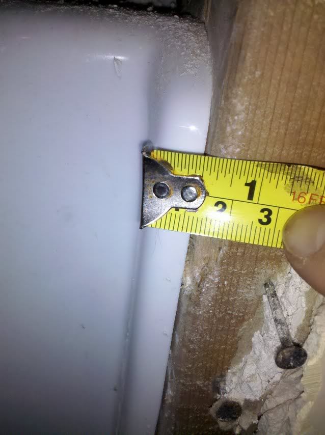

Ok, so my wife and I bought our first house and are a few months in to a total remodel. I am currently working on the bathroom. I completely gutted it down to nothing but the studs. I put in a new window, new insulation, new plumbing, new electric with all GFI receptacles...I was feeling pretty good because no corners were cut and everything was looking decent. Last week, I installed a new tub, got all the plumbing connected, no problems. Today I was ready to install my shower surround, and I began to notice something. Rather than a nice flat lip (or maybe you would call it a flange) on the outside edges of my tub there is a somewhat beveled (or rounded) lip. In fact, it sits almost 1/4 inch higher on the stud. I always thought that the proper technique was to bring your backer board or greenboard over the lip and then caulk the gap for a nice smooth, tight transition. However, I don't think the lip is flat enough to do that. Additionally, the tub lines up with the corner of my "shower wall" and I now have no idea how to finish the wall and create a clean corner. I know none of this probably makes sense, but hopefully the photos help.
PS ignore any remaining drywall in the photos, it has since been removed.
Any assistance would be greatly appreciated as clearly I am lost here!
Thanks!

Not that I'm a Pro...but the pics are a little confusing ..poss cause they are so close. Are they the tub or the surround? Could you take one a bit further away? How does the surround attach? Is there any flange for screws?

Thanks for the reply...this is one I had taken from further away. You can almost see the floor in the bottom of the picture. And notice how the flange tapers in width as it goes down towards the floor.
Anyway, it doesn't really matter, I just got back from Lowes where I opened up the box to the same exact model I have to find that it had *gasp* a nice flat flange that would fit flush against the stud. Mine is apparently a defect, which is why I had no idea how to overlap the flange.....well, at least I'm not a lunatic after all. So now I have to tear out my brand new tub to return it. Unbelievable.

Add a 2x4 or two to bring that wall out then install 1/2" drywall and finish like you would a normal corner. 1/2" drywall will bring the wall even with the surface of the tub lip. Then tile around the tub (covering the lip/flange) and caulk seams.
