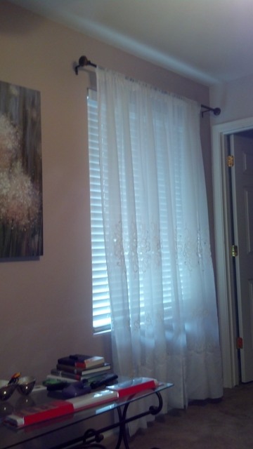

Hey guys,
I'm looking for some tips to remove a small section of dry wall that will later be re-installed. We had a bee infestation about a year ago right above a window on our second floor. Recently we started getting some small beatles coming in through the electrical outlet adjacent to the window. So I don't think the exterminator properly cleaned up in the wall when removing the bees and their honey comb. I want to remove the drywall around the window, and clean/remove insulation, and hopefully find where the bugs are coming in and seal it up. I don't want to just start blindly cutting the drywall. It is texturized, and I would like to try and preserve it if I can for re-use. Any tips are appreciated.

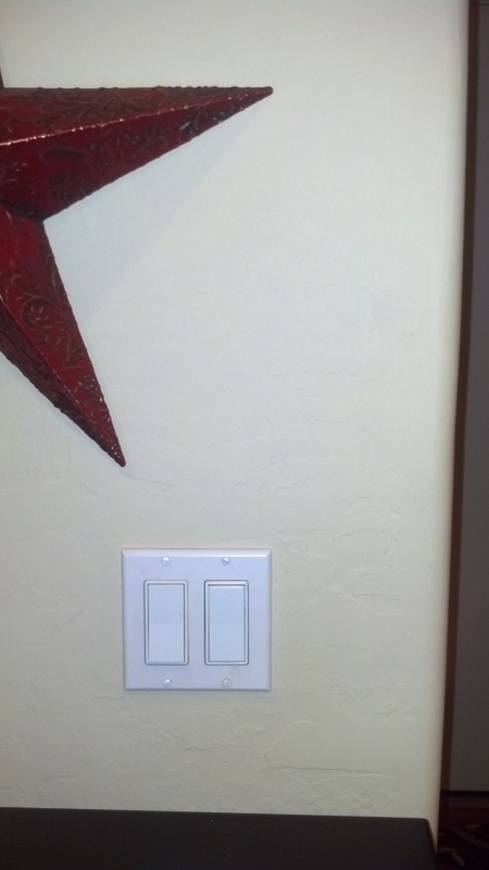

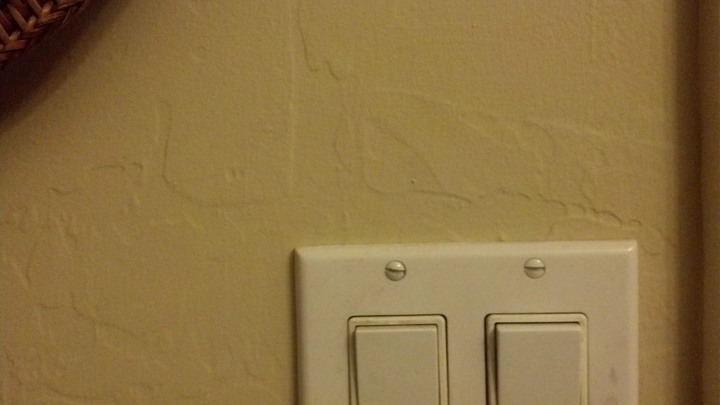

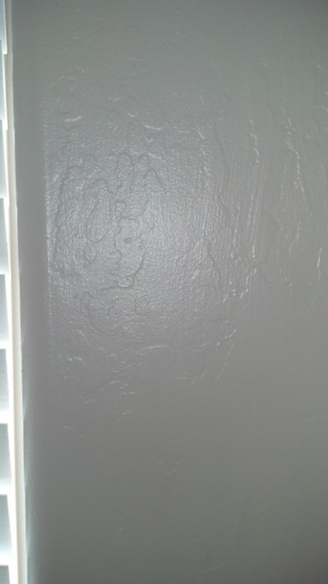

When you get a chance, post some pictures of the wall texture. Someone here might be able to identify how it was done, and how to proceed with repairs.
You're going to have to tape and float the edges of the repair anyway, and that's going to pretty much wreck 99% of the texture you are trying to save on your little patches.
Looks like skip trowel, where someone flicked thinned mud on the wall with a knife, then trowelled it. IMO, the long thin lines visible in the upper right= a bad texture job. This will be hard to match.
I'd try to carefully power sand an irregular area roughly 12" away from the edges of your repair, picking and choosing some flat areas to end the sanding at. Then I'd carefully mask off the textured areas (irregular edge) you want to leave. Then tape and float the patch out until it's perfectly smooth. (check with 12" wide knife on edge so that it doesn't rock back and forth significantly on the hump you taped.)
When you are ready to texture, try to match the pattern as best as you can. Thin the mud. Small flicks, or even dab on a few spots with a 1" paint brush. Big dabs will flatten out with the trowel and will get too big. Small, irregular shaped dabs will be best. Don't let any texture touch the masked edges... get close, but not too close, and leave some variation in the texture spacing from the masked edge. Let it set up just slightly, followed by a very light touch with the trowel. Carefully flatten the edges first and trowel toward the center, but trowel vertically if it looks like thats what the last guy did. Once it's all dry, remove the masking around the edge and lightly sand with a pole sander. Touch up the perimeter with a sponge sanding block.

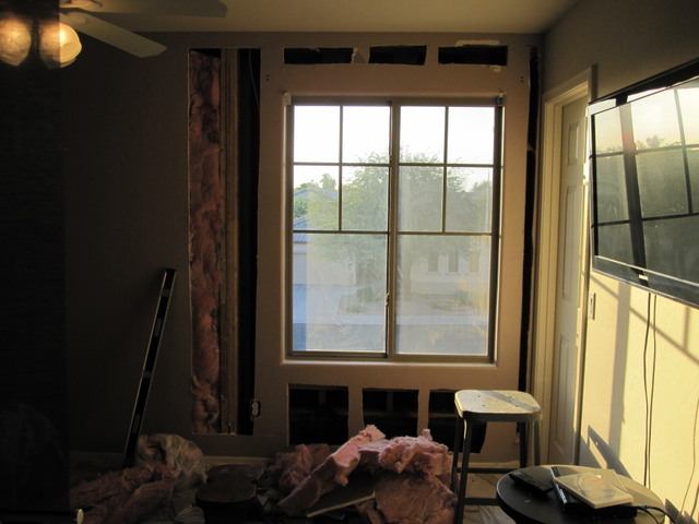

Well I have the wall torn apart, and have the interior of the wall cleaned, sealed and ready to have drywall put back on. My plan is to screw some studs to the existing studs that I can then screw the drywall too.
I have some questions about ow to finish the drywall properly. I plan to get the new drywall in place, and then sand the existing texture/paint off the adjacent drywall. After that, apply the mud and the tape to the new seams. The texturizing is what I have some questions on. I would obviously like to match it as quick best I can to what we have. I cannot tell if this is skip trowel or knock off. If anyone has an opinion, that would be great. Worst case is, I may hire someone to do the texturizing.
Here is pretty much how the wall looks, although a couple of the edges have been straightened up, I have a little more trimming to do to to get the edges square.
images of the texture, I tried to put something in the figure that would give it scale.
