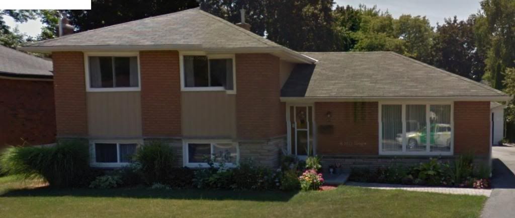

I was slightly incorrect on the roofline in the drawing. Here's a picture of the exterior of the house:
The floorplan is for the main floor only.
What would I be looking for in the attic in this case? The trusses where the roof line begins to fall off being connected to the trusses that run North-South with no loading bearing transfer under each of them?

Okay, that took longer than expected.
Here is a picture of the attic. Those supports seem to come down directly on the corner of the interior wall. I guess that means it's load bearing and I am out of luck. Does that make sense?
I just don't understand why they bothered to support such a small part of the roof on that one spot.
