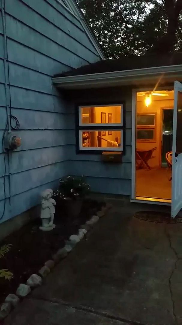

Here's a pic of the outside..

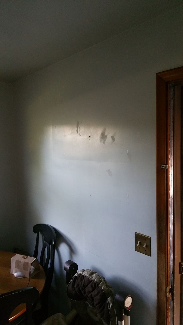

The wall.

The picture from the outside shows a window, while the one on the inside does not. Is it the same wall? If the outside wall is what you want to remove, then yes, it is load bearing. It can be done, but you need to build a false wall inside a foot or so to support the house while you have it down and install your header across your proposed opening.

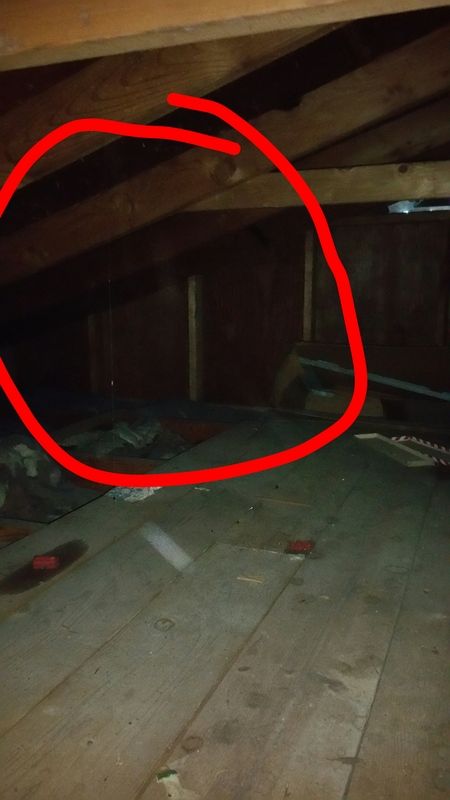

In the attic... don't mind the mess.
The part that is circles is right above where the wall is that I want to tear down.

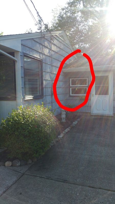

The part I circled showing the house - the wall is between the house and breaseway. Not the breaseway front door wall.

This is looking in the breaseway door from the outside showing the wall I want to tear down.

The wall with the double windows is a load bearing wall since it is actually the outside wall of the original house structure. How much of the wall are you wanting to remove? It will need a header, similarly to what I described in post #7. Did you ever determine if you have trusses in the attic or not. That may make a difference.

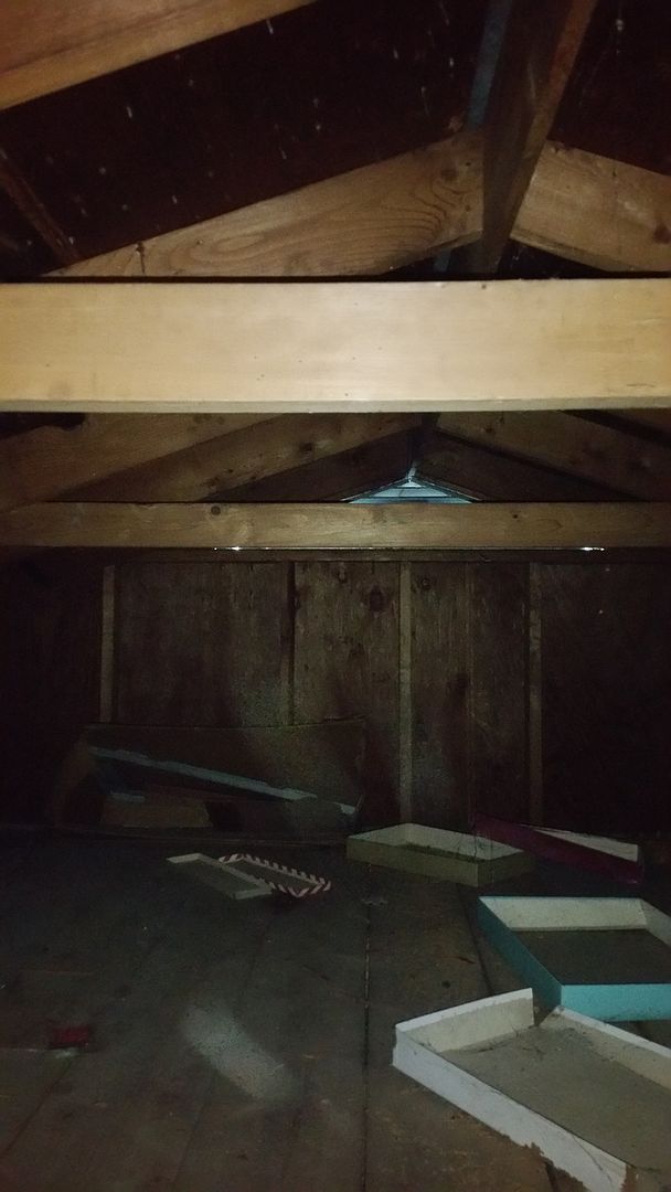

It looks as if it does have trusses. The outside wall is not the one I want to tear doen, but the one inside of the breaseway. Here is another shot of the attic.

Those aren't engineered trusses, but if the roof/attic framework isn't resting on the wall in question - then it isn't load bearing.

The wall you show in post #10 IS an outside wall. It was constructed as such when the original structure was built. The breezeway was added on it appears. Now it is INSIDE the breezeway, but for construction purposes it is load bearing. Clarify which wall you are referring to in post 10.
