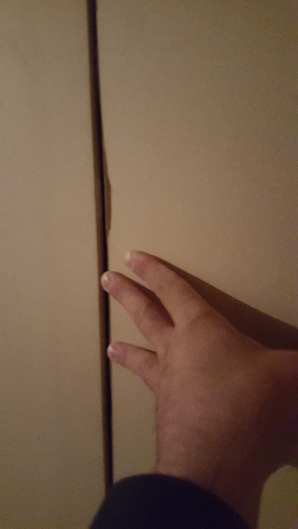

Garage drywall doesn't have backers?
Just moved into my house. The garage has drywall hung. The seams of sheets slope down towards each other. It's my understanding you mud and tape these to paint etc.
The problem is, at the seam, one sheet is secured to the stud. The other is essentially floating.
To my understanding they were supposed to screw a secondary backer beam into the stud which the other sheet secures to so both sheets could be secure at the seam.
Other wise when you paint etc it's going to flex at the seam from various things and crack.
Anyway to resolve this without taking all the sheets down to put a backer and reinstall ?
Thanks.

Well
I'm saying the at any given seam, one sheet is solid. The other can be pushed in with not too much effort again at the seam.
Old 04-07-16, 09:38 PM
F
Join Date: Apr 2016
Posts: 13
Received 0 Upvotes on 0 Posts
Example
I'll see if I can't post a video
Old 04-07-16, 09:40 PM
XSleeper's Avatar
Join Date: Dec 2004
Posts: 26,394
Received 1,743 Upvotes on 1,567 Posts
I don't see screws in either side. Is this a wall or ceiling? Are the seams vertical or horizontal?

Old 04-08-16, 05:17 AM
F
Join Date: Apr 2016
Posts: 13
Video
It's like one side of each sheet is secured. And the other isn't. I'll take a picture from further away in a sec

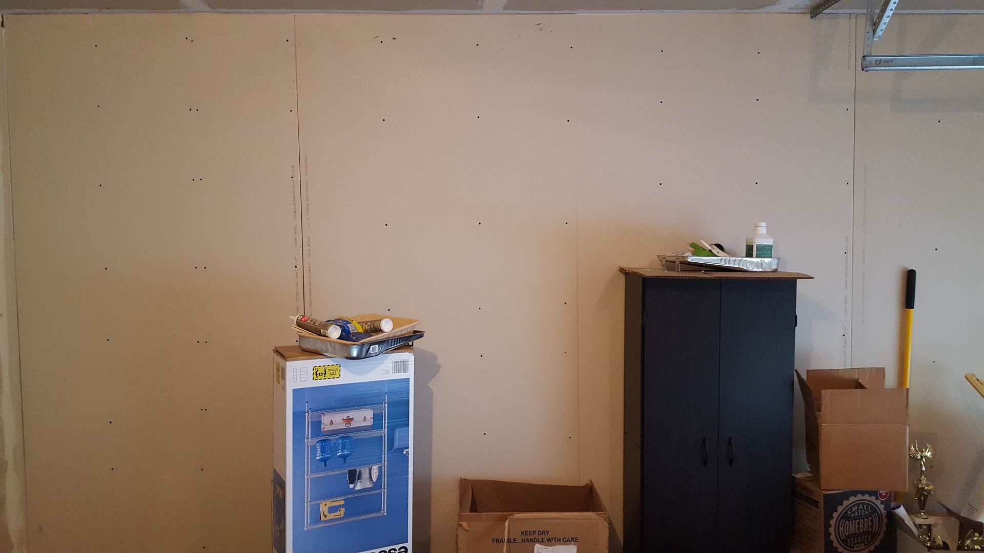

F
Join Date: Apr 2016
Posts: 13
You can see here in this picture 4 panels that are all secured on the right edge with screws.
All the left edges have no screws.
Old 04-08-16, 02:49 PM
XSleeper's Avatar
Join Date: Dec 2004
Posts: 26,394
Take a thin putty knife and put it in the joint... then run it up and down. If you hear a click or feel it bump over something, they used backup clips, which may allow th e sheet to flex a little, but thats normal.
If there are no clips, then its a different story.
