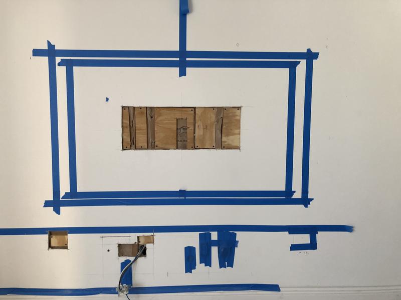

Thanks pitching in guys and I'm sorry for the delay.
So here is what I did:
Here is a Tapcon performance table:
https://www.tapcon.com/getattachment...ss_v0-1_c.aspx

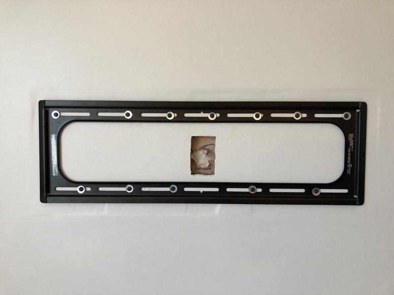

Based on performance table and what you see in these pictures, do you believe it is safe to hang an 80 pounds TV in there? If it comes down it will be $2200 for the TV, plus the rack bellow it plus the damage to the wall so it an accident happens it will definitely cost me close to $4000.
- I opened the wall just enough.
- Used plywood to close the gap between the drywall and cement blocks (tapcons were use to secure the plywood into the blocks). This should prevent the TV mount screws from bending.
- Used tapcons to secure the TV mount.
Only issue with that approach is that your drywall is now sunken in. Same thing happened to me when I was hanging my TV over the fireplace. I ended up adding some joint compound and repainting the wall, so it is no longer visible. You'd be fine to leave it as-is since the TV will cover it up. The bracket looks sturdy enough to me!

I missed this thread originally although I did respond to a similar one. I use sleeve anchors and spacers to mount a TV to a block wall. Most TV mounts come with bags of extra hardware and typically plastic spacers. I set four anchors in the block and then slip four spacers over the bolts and then fasten on the bracket. The spacers allow the bracket to be tight against the block without crushing the sheetrock.
Tapcons can be risky in that their holding power is based solely on the material and the hole size drilled. You aren't concerned with their shear strength..... you'll never approach that. You need to be concerned when you pull the TV away from the wall..... the stress placed on the top screws that they don't pull out.
You have used a lot of screws in your mount. I don't think you'll have any problems. Make sure that all the top screws have caught well. They are much more important than the bottoms ones.
One problem you will probably run into is trying to plug your TV in with the receptacle right behind it. I try to keep it above the mount because the TV is usually tipped down giving you extra room for a plug. They do make recessed boxes and receptacles but would be difficult to use in a block wall.

If the bottom picture is the final product, with 12 Screws, that works out to only 7 #'s each, you nailed it!!!
Didn't realize you were hanging the TV closer to the floor like that (I just noticed the base moulding). If you're putting a media cabinet underneath, that will hide the electrical outlet. And you could conceal the cables running to the TV through a short piece of wiremold right down the center.
