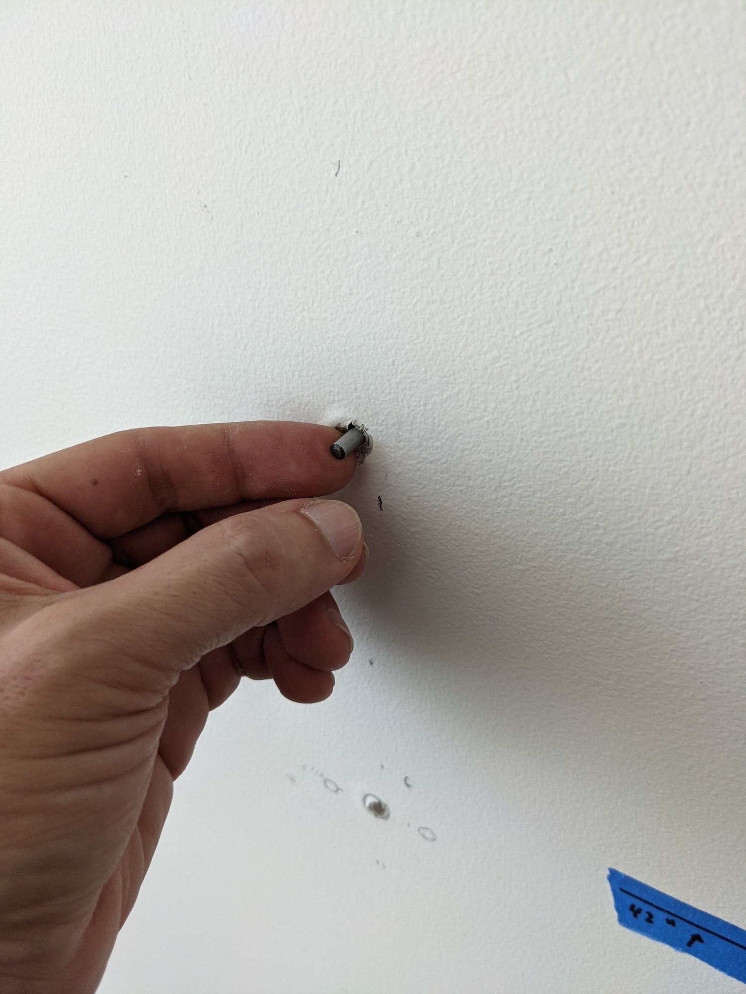

Hello all, I'm trying to hang a 55 inch tv on the wall of my sisters condo, this building was built in 2006. I bought a Franklin M10 stud finder from harbor freight, I wanted the m150 but they didn't have it. I tested the stud sensor and marked the studs, I made sure to run and mark the stud vertically to make sure I wasnt getting a wrong reading on one spot. The tv frame says to drill a hole no less than 2 3/4 inch dept with a 5/32 drill bit.

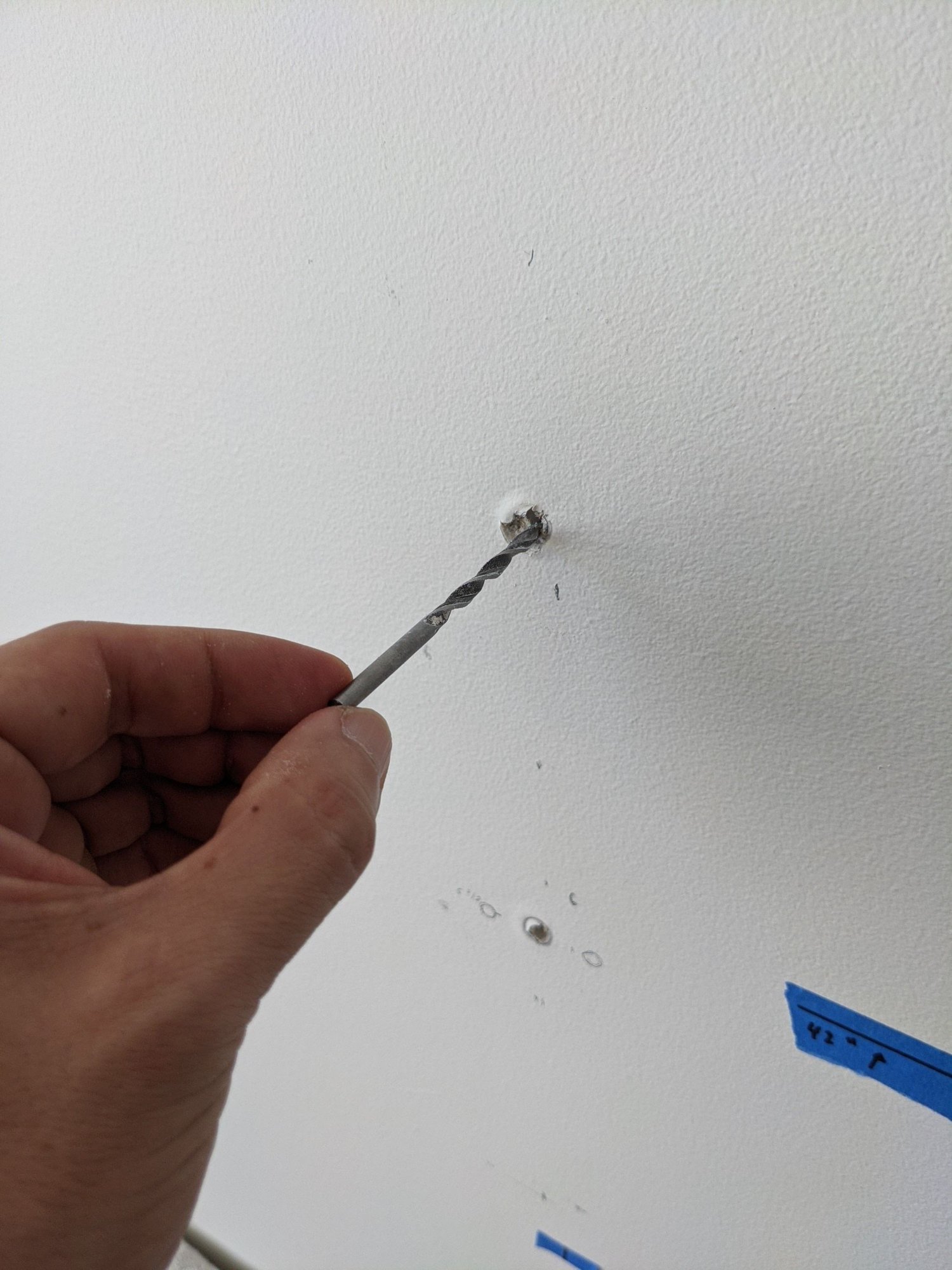

i drill and passed the drywall, then it was a pocket of air, something bouncy like insulation and then something hard and it went through but nothing like wood.
In one of the pics you can see how the bit can go all way through without resistance. This tv is heavy and the frame is heavy I think that I'm not hitting a wood stud. Any advice on what am I hitting?

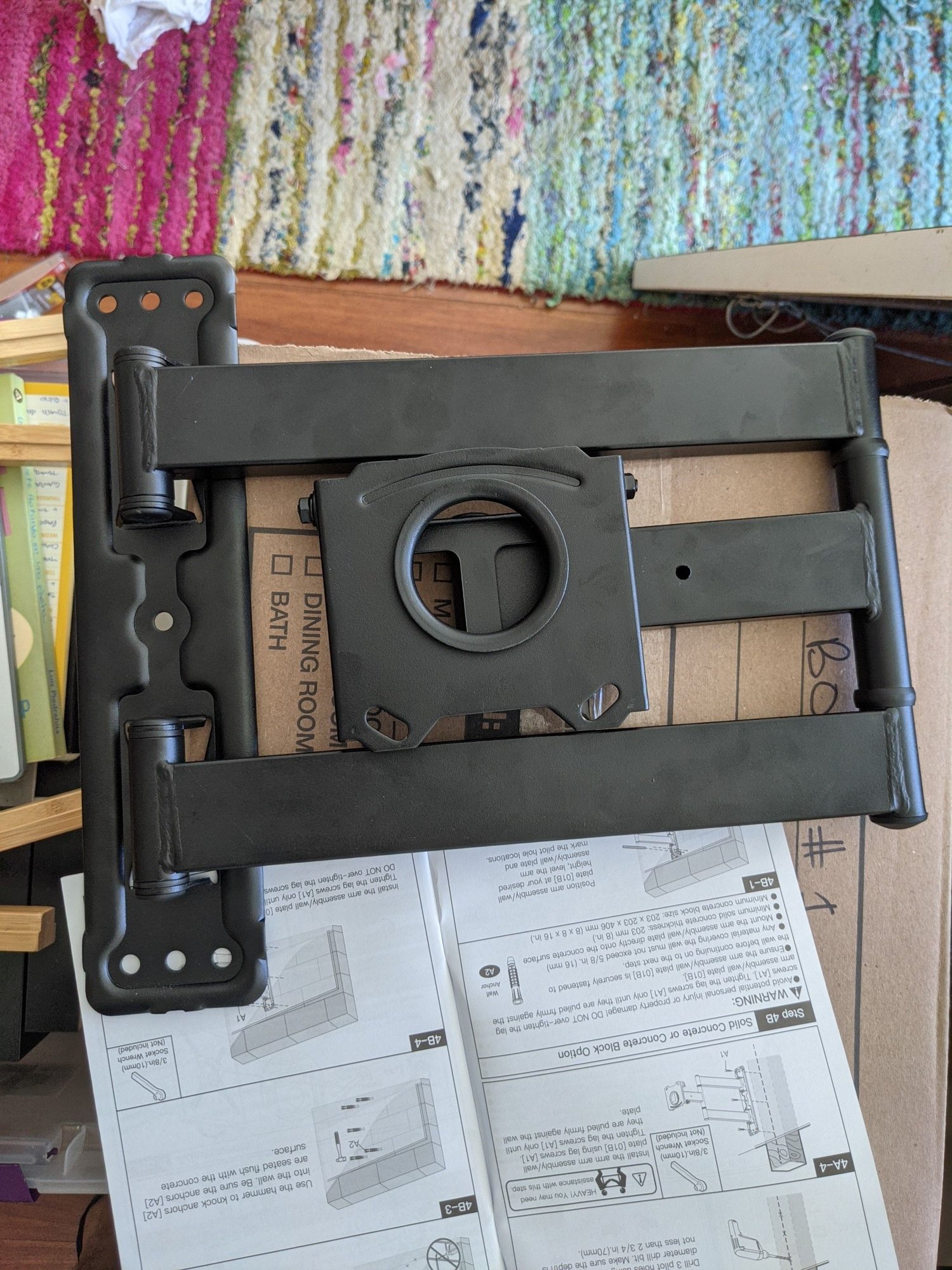

This is the frame
Bit goes through with no resistance, after the drywall there is some material that feels like insulation, then while drilling I hit something that was not like wood, maybe a metal stud, after adding more force it went through.

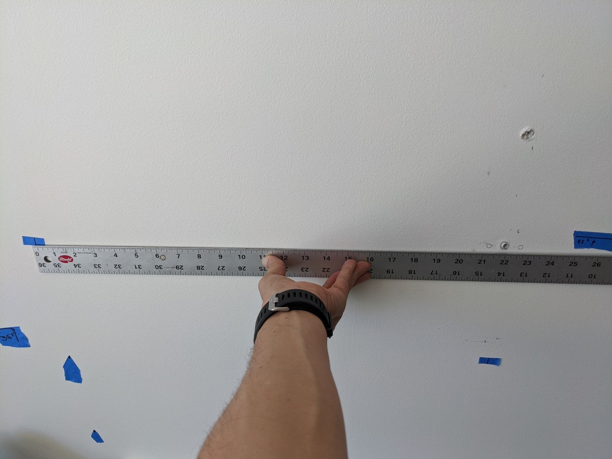

I measured to the left for the next stud and is 22 inches, to the right to the next stud is 19 inches, pics below
From the hole I drilled(stud finder says it's a stud) to the left and to the next stud is 22 inches
From the hole to the right and to the next stud is 19 inches

Standard studs should be at 16" centers. Is this an original wall built with the house or an add on by previous owner?

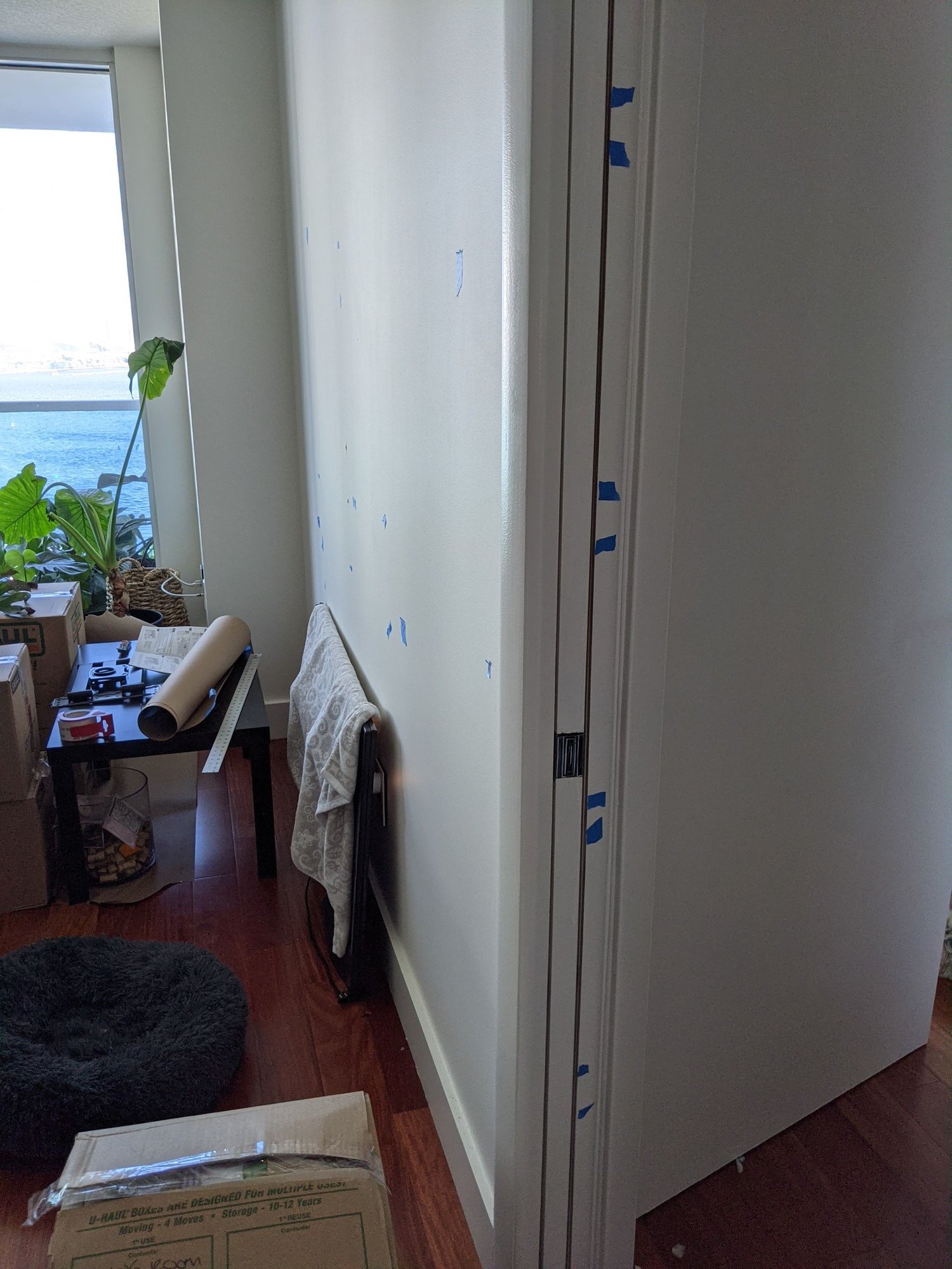

All the walls are original, building is from 2006, we just moved in it's a 22 floor condo, I just found out about this sliding door that goes into the wall thou, I saw some 2x4 running horizontally.
I used a used a pen on both holes to see how far deep it went and it stopped around 4 1/2 inches which seem to be the other drywall interior from the other room. I don't think there is a stud there. The stud finder might be marking something else although it alerts of a stud vertically from the top to the bottom. I'm scratching my head now.

I added red lines where there should be framing......
- At the end of the door.
- Directly to either size of the electric box.
..........BTW..... receptacles are not typically found near/over a pocket door.
-Another in the corner where the walls join. This one is probably a normally oriented stud.

Looking on the side of the pocket door I see 2x4 running horizontally, blue tape marks the ends of each 2x4. No vertical stud next to the door frame that I can see.
Tape marks all the horizontal 2x4s

Could you be finding the side of the door? Close the door completely and see if the stud finder still shows a stud. Also, is there a hole in the door?

Couple things I learned yesterday from a friend that is into construction, Miami code has new construction with metal studs and this is a fair recent construction (2006) so there are no wooden studs, I'm thinking about heavy duty anchors but I'm afraid that this is a swing mount so when it extends the stress on the drywall increases, the mount also has the holes in a vertical pattern, 3 screws.

If you want a secure and stable mount then mount a piece of plywood or two 3 x1 strips of wood mounted to at least two of the studs or horizontal members. Then mount the swing arm or TV mount to the plywood or wood strips.

Cut out a piece of 3/4" plywood that is as big as your mount is. Put it on the wall and drill 4 holes in it near the corners. Mount that to the drywall with toggles and PL200. Then screw your TV mount to that.
