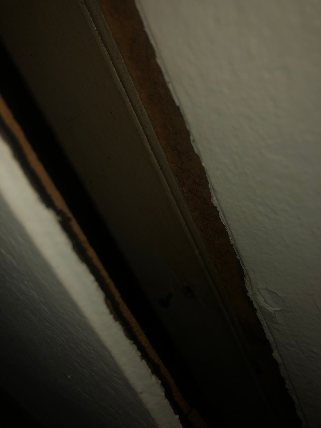

My house was originally built in the 1930’s roughly, and they added on a second half (bedroom and bathroom, there’s notes in the photos that’s why I’m mentioning it) around 20 years ago. This problem is the ceiling in the foyer front door area, approx 8.3ftx9ft square like shaped.
The people who lived here before said it’s been caving for awhile (we moved in dec 2019.) But it’s been getting progressively worse. This room has a closet with an attic entrance and my fiancé went up one time and said the “floor” is covered in insulation.
I tried to tap it up to see if it would move and it feels super fragile like it’s going to collapse.
I don’t see furring strips, and I’m not sure how it’s suspended there. I see nails but I don’t see many nail spots on the outside of it when you look up. But there’s approx a 5inch gap between the ceiling and what’s above it and when you look inside the gap you don’t see much. DIY won’t let me upload a video so I tried to get as many pics in as possible.

I’m just not sure what to do. Try and knock it all down? Get glue or nails and try to push it back up? Above the ceiling looks like really not pretty shiplap lol. I can’t see how these are actually attached to it. Like pretend the gap wasn’t there & the ceiling was still in place, would that space between the ceiling and the “shiplap” still be there? How is the ceiling attached? That’s what I’m so confused about
The good news is this ceiling (the whole 8.3ftx9ft) isn’t attached to any other ceiling. It’s cordoned off basically room to room. Diff ceiling in diff rooms.
To me it looks like this kind of ceiling is interlocking, as shown, BUT the thing is it looks like long pieces of squares in strips. Aka why it’s falling like this specifically.

This is why I think it’s interlocking Other side of this wall is the bathroom (to the right of the bedroom/bathroom doorway) & in that room (to the very right of this picture) is actually where a water spot is This is what’s above the ceiling (peaking into the 2inch gap this is what’s above it) Where they separated at the 2in gap
Standing to the left of the front door. Almost a 2in gap. It honestly probably is 2inches though lol The deep part of the gap Pressing my phone into the gap this is what’s there. It looks like there’s about 5inches between the top side of the ceiling and whatever that is above it. Again showing what’s above it. I don’t see furring strips but what else is it attached to? Is this suspended? To me it seems like a bunch of long strips of tiles somehow suspended Where the deep gap separates from the ceiling that’s still attached
For a room that is less that 10x10 and what 20, 30 years old I would not waste any amount of time trying to repair! There are so many unique and easy to install options avaialbe.
We have several rooms eith Armstrong ceiling products, they look fantastic!
