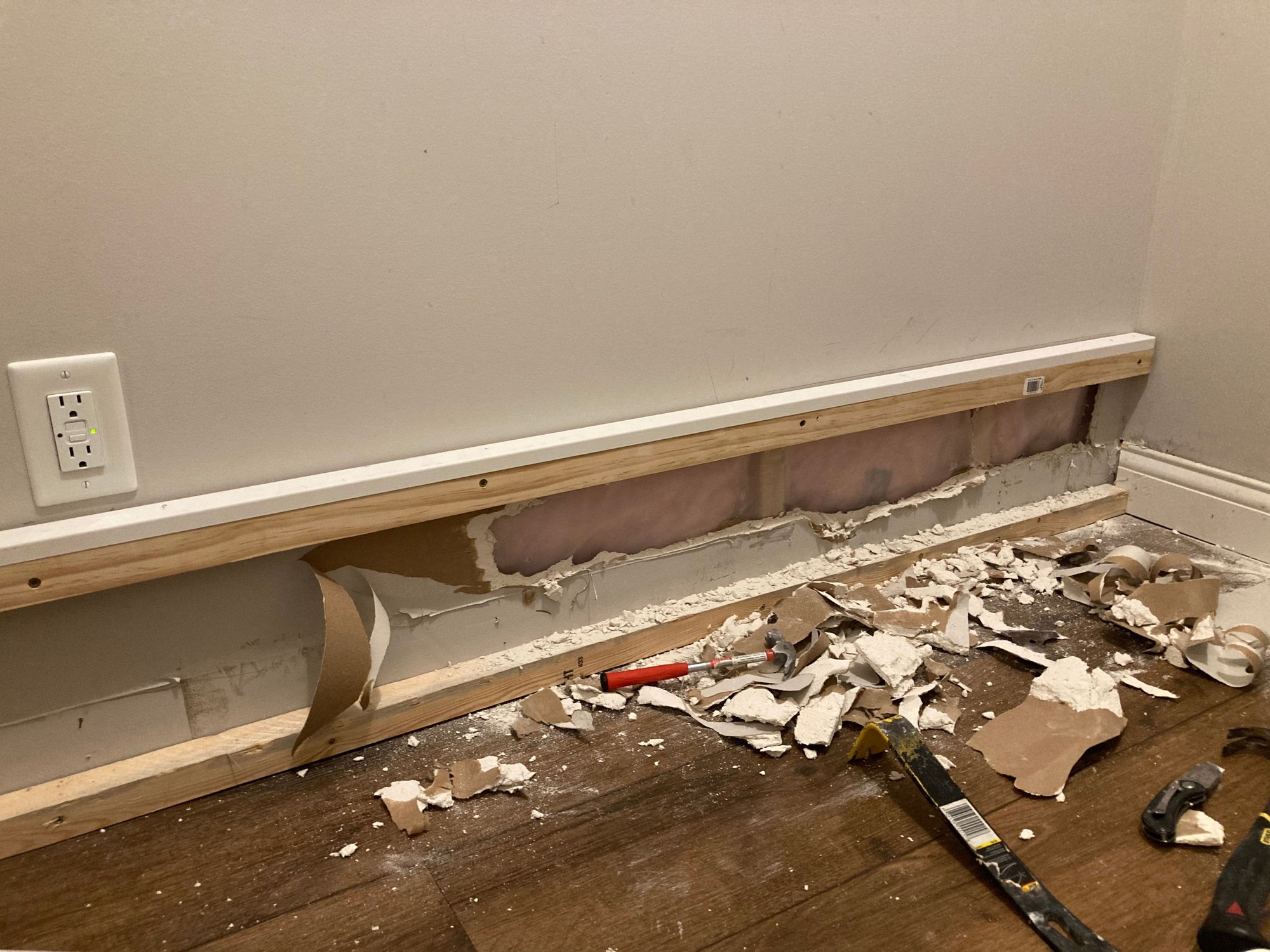

See pic. I need to remove about 4 inches of drywall between the 2-2x2s you see on the wall. I am running a drain line and supply lines to/from a vanity along this exterior wall. I want the plumbing in the warm side of the insulation so it doesn’t freeze. So I am going to build a small chase to hide the pipes. In order to minimize how far out the chase sticks out, I am removing the drywall where the the 1.5” drain will run to gain an extra 5/8” of space.
I’m looking for feedback on the best way to remove this section of dry wall. I can’t use a drywall saw as there is vapor barrier behind the drywall that I don’t want to cut. Any suggestions on best methods?
