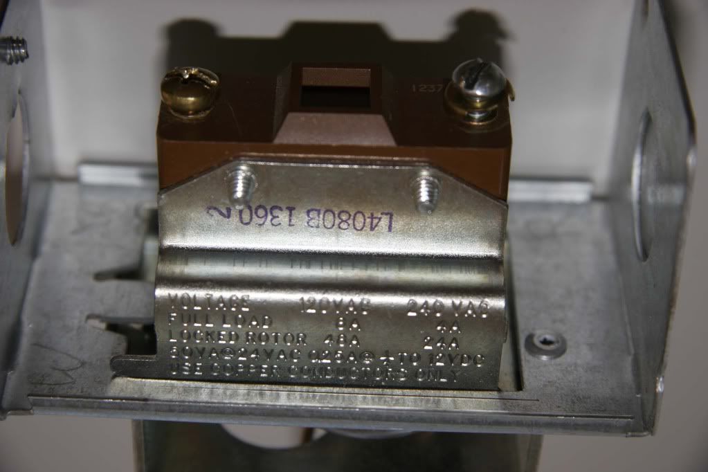

Foto 3
shows the Honeywell L4080B 1360 aquastat and connection where warmed domestic water enters the Mate.

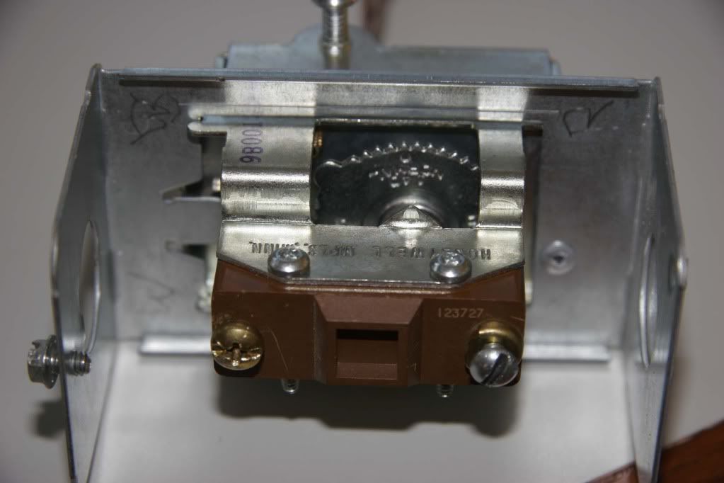

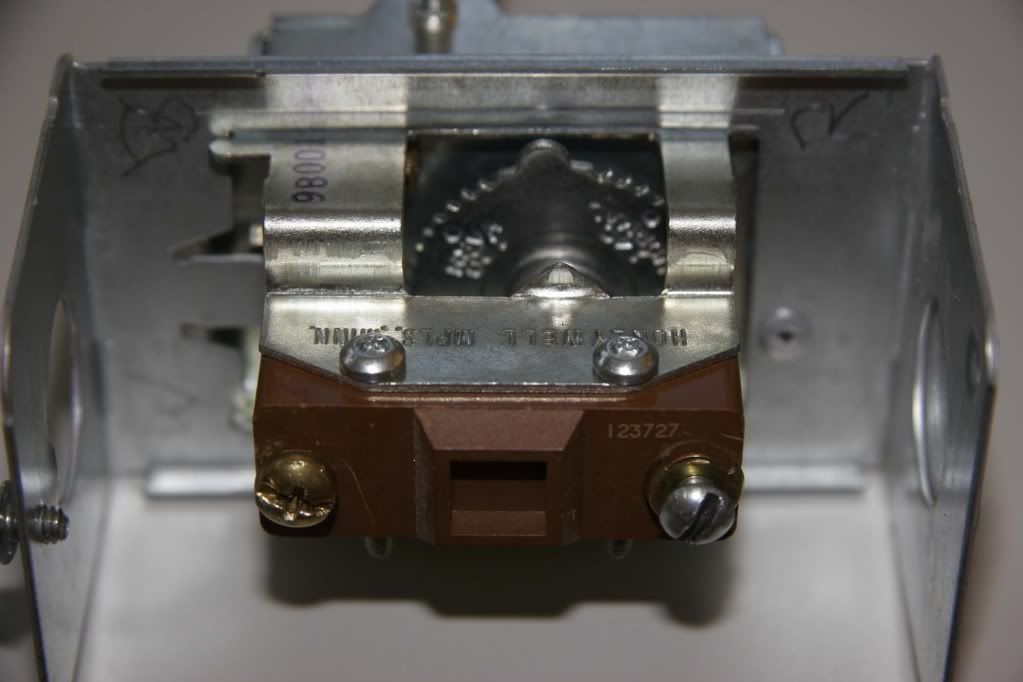

Join Date: Nov 2005
Posts: 41
Received 0 Upvotes

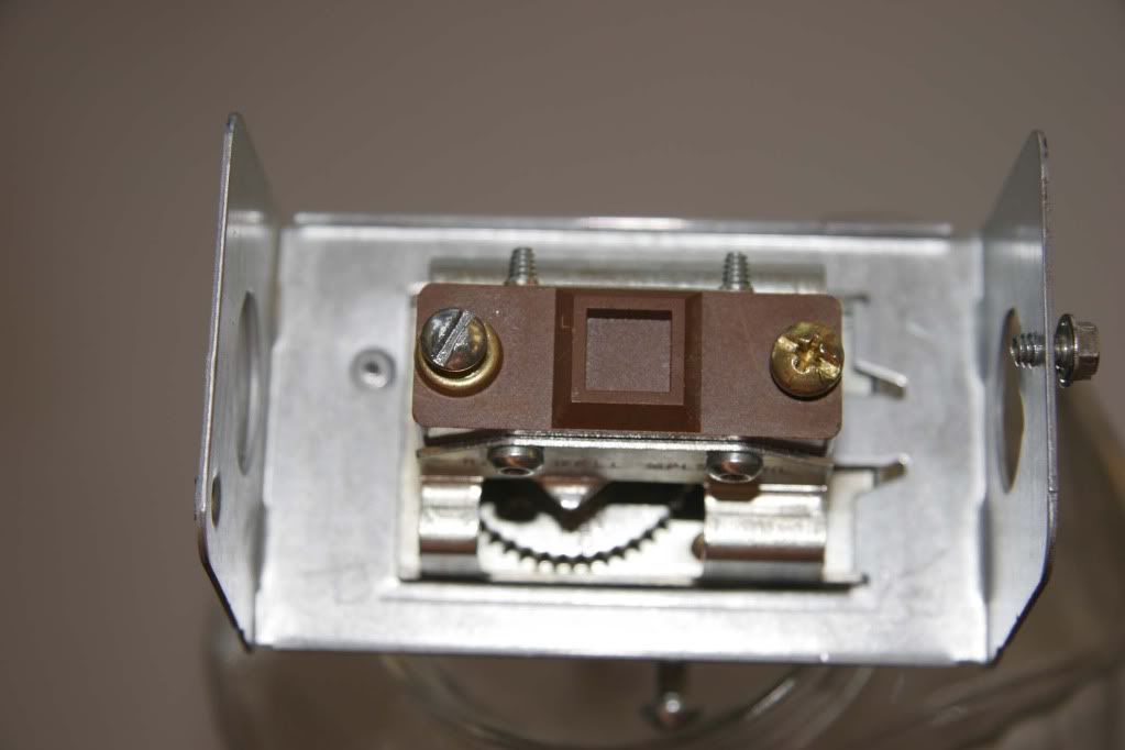

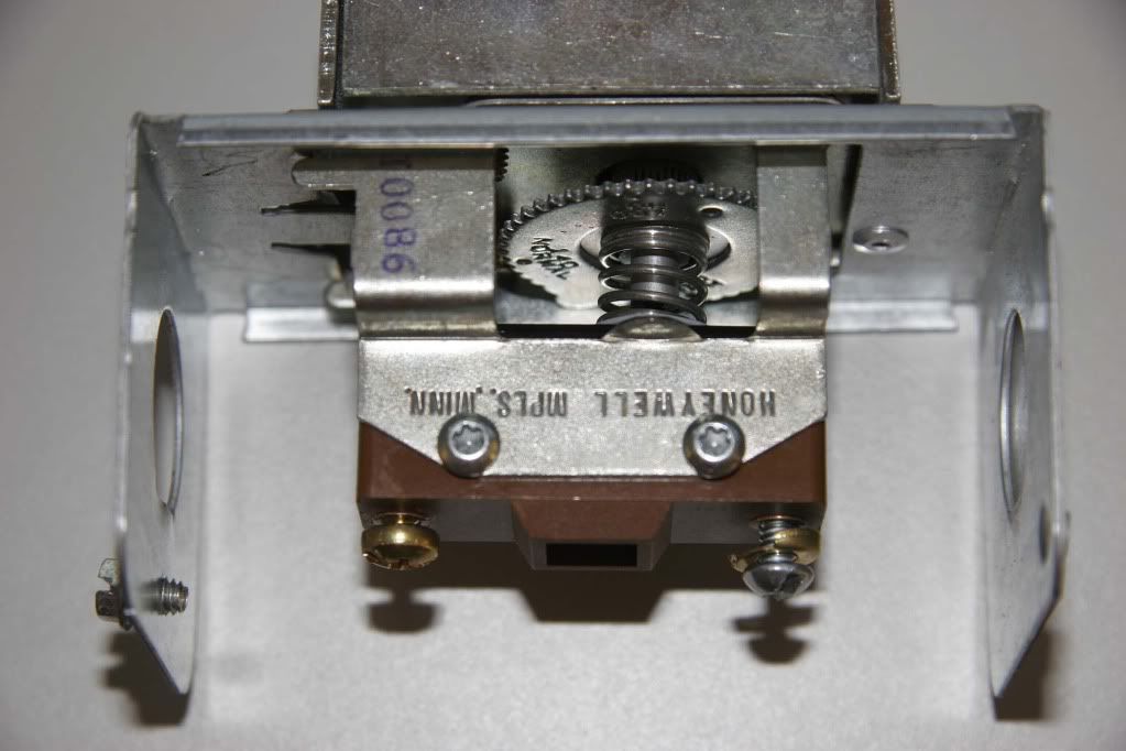

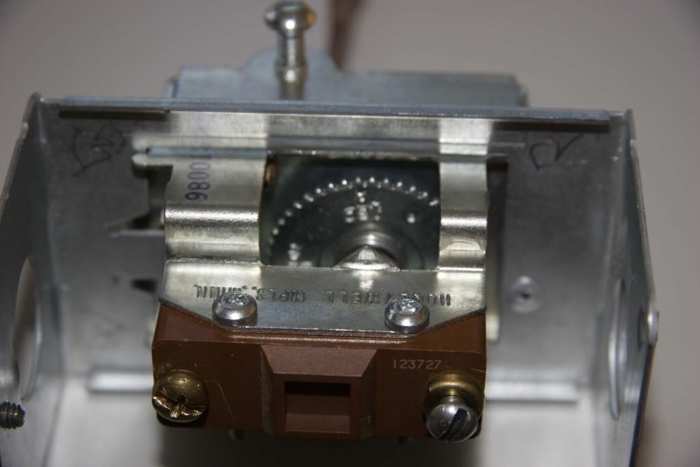

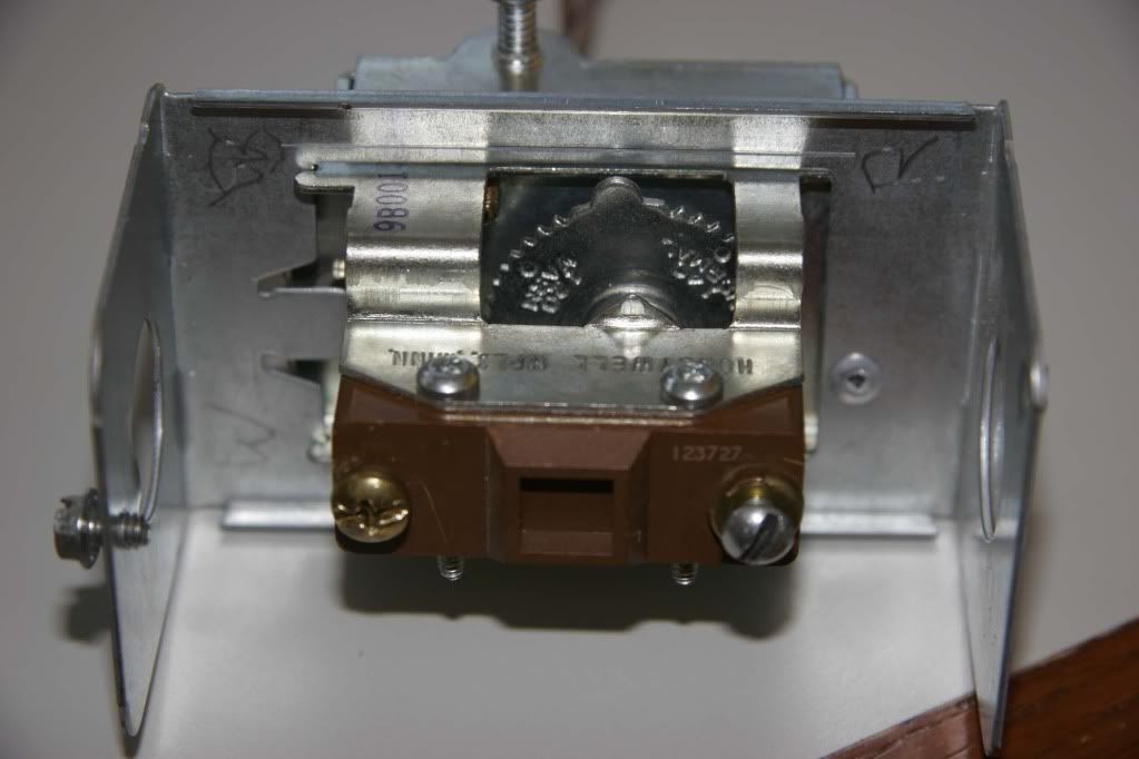

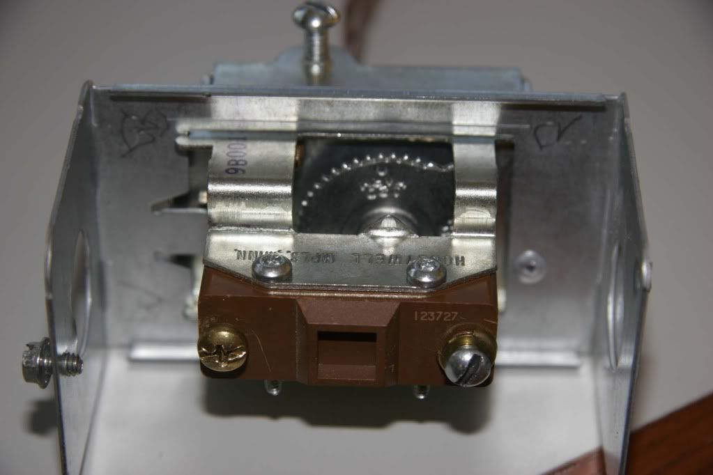

Hi Furd,
I jumpered the connections and after wahile, the domestic water wen fro 147 to 154 degrees.
The included photos are as good as I can make. The stamped writing on the dial is very crude.
So, you think this aquastat can be set to turn off at approximately 165 degrees? Or do I replace this aquastat with one that can be set at 165 or higher off temperature, and if so, what model?
Join Date: Mar 2006
Posts: 16,321
Received 38 Upvotes
30 Posts
I suspect that the aquastat is badly out of calibration for some reason. You could bend the stop and adjust higher in small increments, testing the water temperature periodically until achieving the desired temperature or you could replace the aquastat. Any model that "opens on rise" will work.
