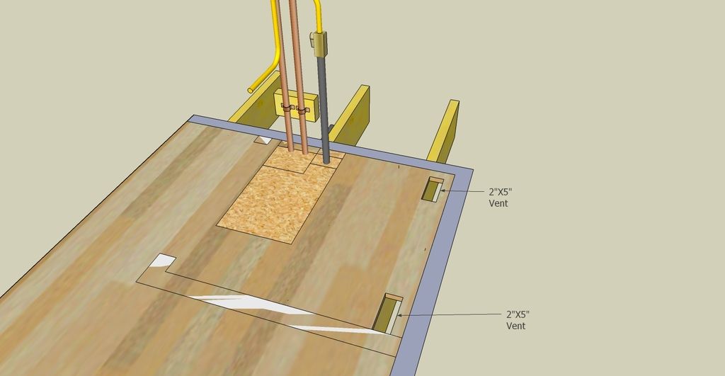

Hi guys. Well, it's been one hell of a week getting things ready for this install. Got lots to show, but no time right now. However, I have an important question. This water heater has something on the bottom that the description in the manual(what a joke too) calls a "Flame trap" and other online illustrations call a "flame arrestor". Can someone tell me what this is for? Thanks.
btw, here's one sketchup showing pipe planning..
[IMG][/IMG]

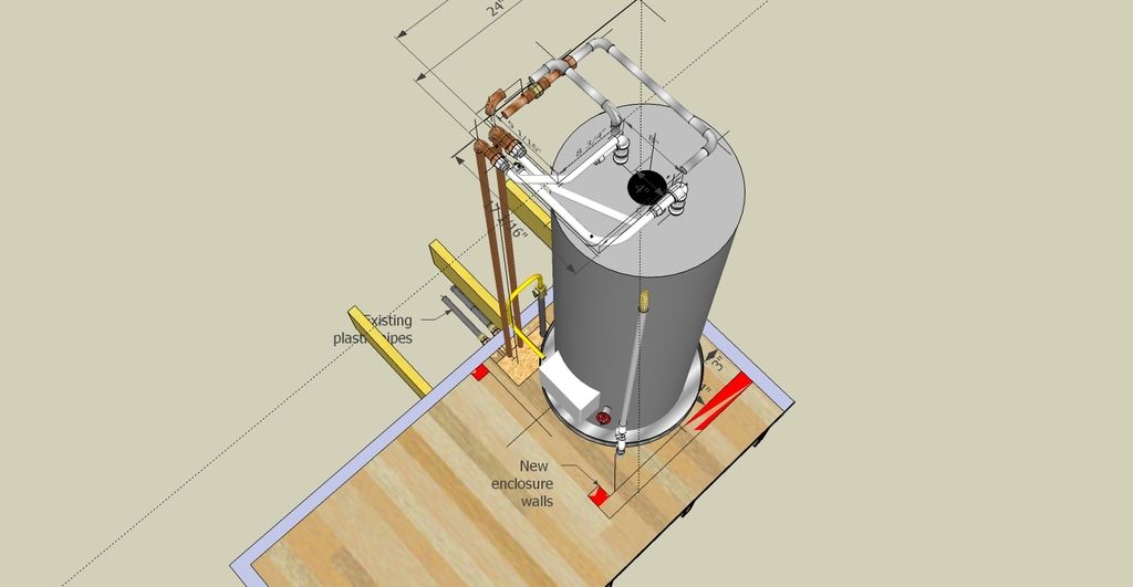

Old 11-12-17, 09:16 AM
F
Join Date: Jun 2015
Posts: 165
Likes: 0
Received 0 Likes on 0 Posts
As a quickie.. here's the final plan. I did this to ensure I didn't forget anything.
[IMG][/IMG]

#$#@^%*%&(*O(%%$%# ?Arrrrgggggggggggrrrrrrrrrrrrrr
ALMOST MADE A MASSIVE MISTAKE!! I measured a dimension from the edge of the cutout to the gas line centerling. Unfortunately, when I used the dimension in Sketchup, I used it from the wall. Thank goodness I laid the leak pan in place before doing anything else,, and something wasn't lining up. This would have caused me to cut the vent holes in the wrong place. And THANK GOD I didn't. After moving the vent layouts to the correct place and cutting them.. I discovered had I cut them in the wrong place, I would have cut directly into an electric romex cable.
GAK!. Here's a pic of the wrong position. Had to move them 4" towards the new enclosure wall ...and had to move the wall too.
Ok.. onward
