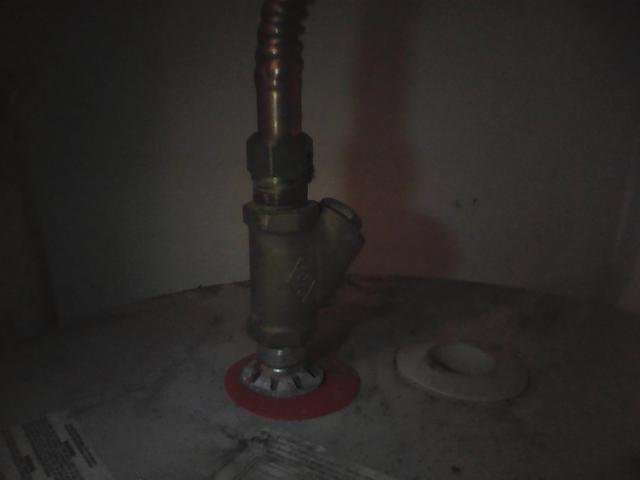

Working on draining the old water heater now as per advice given. I noticed this check valve or backflow preventer perhaps type valve installed on the hot water supply line. Is this normal and should I go ahead and reinstall it in the same place when I install the new water heater? Should I assume if I do re-use it that it is working fine and doing what it's supposed to do?

I have never seen a external back flow preventer on a water heater. Most heaters have small plastic flappers in the fitting at the top of the heater to prevent hot water from migrating out when no water is being used.
Unless it's required by some local code I wouldn't use it again.

I managed to finally get the water drained out of the old heater and then install a new one. I went ahead for now and left that backflow preventer installed in the same spot because I didn't happen to have a long enough length of hot water flex line to make the connection had I chose to eliminate it. I suppose I'll with local code but I doubt it is needed. Kinda curious why it would've been been installed there in the first place.

Was the check valve still working? After a few years of mineral build-up, the gate tend to get frozen in place. I would've eliminated it (got a longer flex).
With the new water heater installed and that old check valve still in place we're getting hot water fine so I'd assume the check valve is still working. I plan on eliminating it and getting a longer flex as suggested, just haven't got around to it, but will very soon. Any idea why the check valve was installed there like that in the first place?
