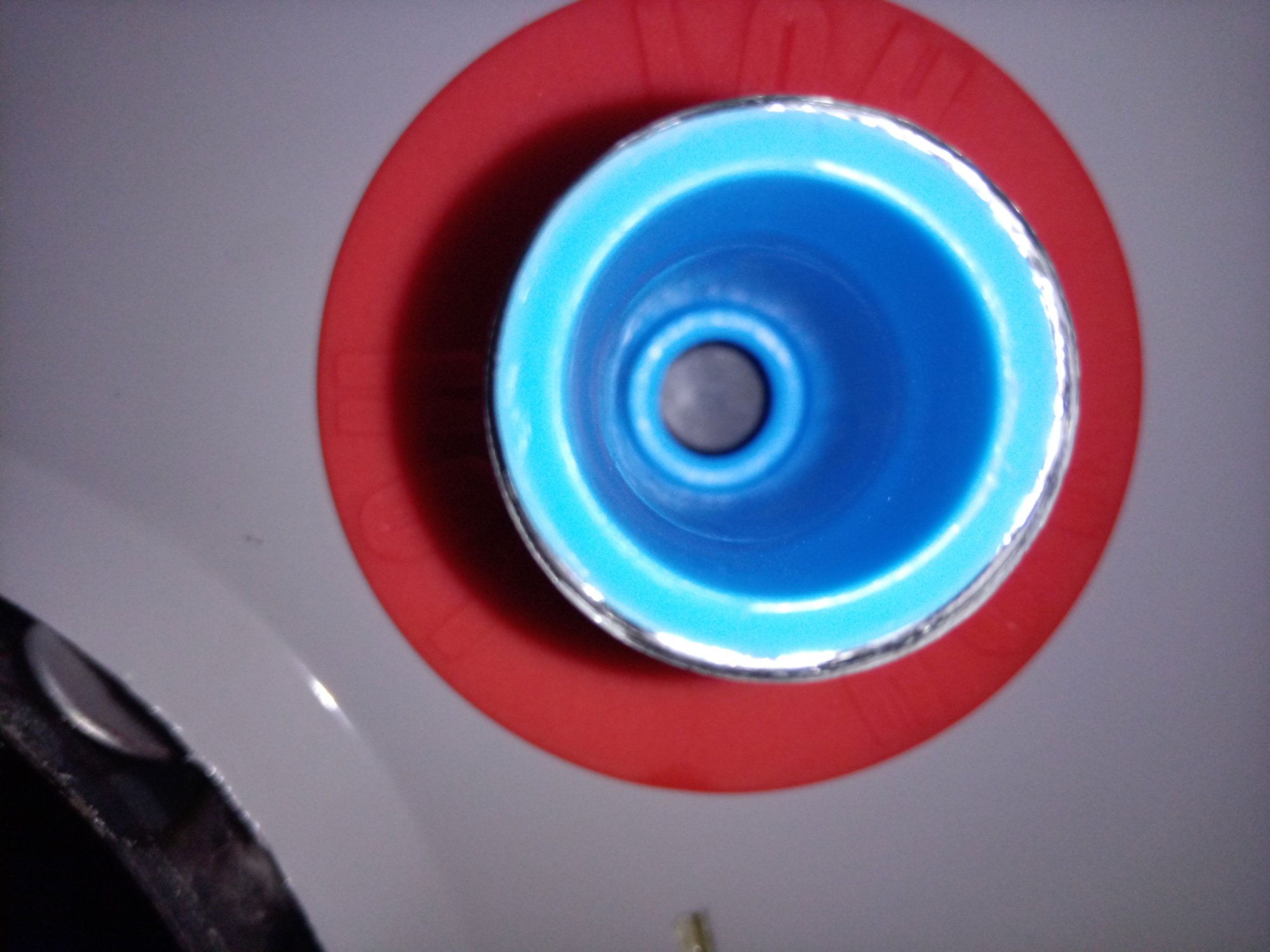

Small black plastic flaps on both cold and hot water tubes (deeper on the hot side). What are their functions? I kinda worry that this small flap may eventually fall off and BLOCK the water pipe somewhere. Should I remove those flaps to be safe?

I've never noticed them on my tanks. But if they don't say to remove them then don't. Back flow prevention valves or flaps?

NO, not the back flow prevention, because the flap go both ways.

OK, did a bit of GOOGLING. Here's what I came up with:
the systems incorporate small metal elements called “nipples” — a small piece of piping with either a ball or flap sitting on the inside. You place the heat traps on the water inlet and outlet pipes. Here, they'll prevent heat from escaping due to convection.
Apparently this is fairly new and is considered very efficient.

I honestly do NOT see how that little plastic thing can prevent heat loss. I worry more about that thing break down and block the water flow somewhere.

Probably just the heat trap nipples many water heaters come with.
