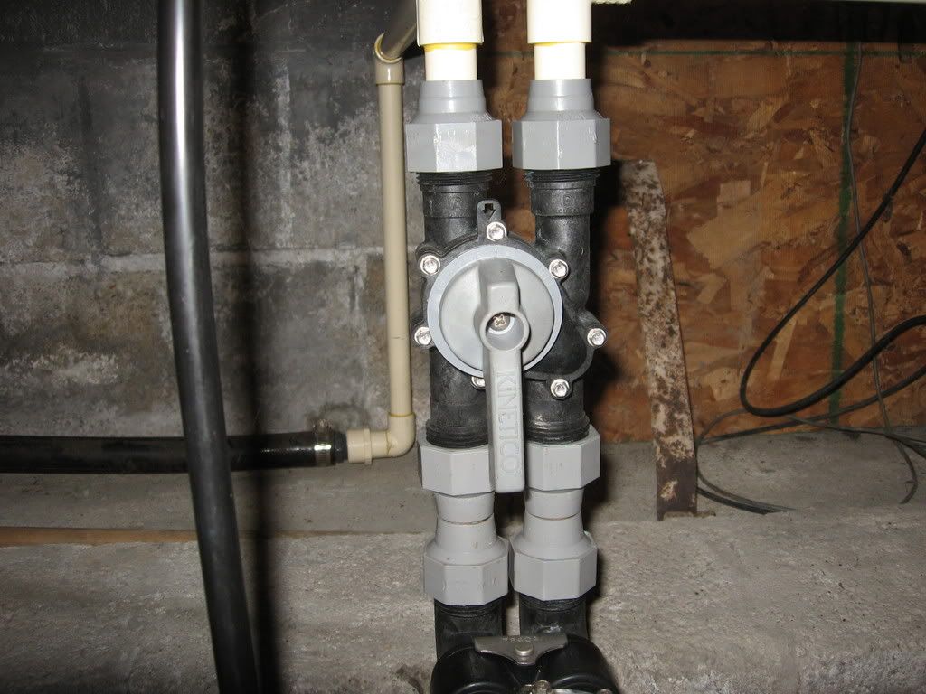

Does your by-pass look like this? This is a one-inch by-pass. The newer one is 1.5".
The OFF marker means the whole house is off--shut down. So this by-pass can provide service, by-pass and
turn the house water off as well.
Also the water can enter in either the top right or top left depending on which way your plumbing is arranged.
Look carefully on the gray disk and you can see A-C or B-C to indicate how it is set. If it is A-C then the water is coming
from top right to bottom right and out the other two. Pretty handy.

Yes, that is exactly how it looks. It has A to C on left and B and D on the other. A and B being in the top. I set the bypass to off and turned on the faucet in the house and there is a steady flow water coming in it after the pipes have drained. Does this confirm the leaky bypass? or is there any other way to confirm it? Also, could this be the reason for my problem?

I took the bypass apart and I find two rubber O rings there. One, a small one by the stem and a bigger one that runs by the edge of the bypass. Which one where you referring to. Both seem to be good. I dont see any broken ones. I pulled the middle stem apart which had like a U. There was a lot of deposit there. I cleaned them out. Do I have to check anything else?

The oring I was referring to is the bigger one that goes around the white piece. It has an oval shape slot it fits in. When moving the handle from bypass to service sometimes would cut the oring. The deposit you found may have caused it to leak by. Check to see if, while on bypass, the water stops flowing to the unit.

Sorry for the late reply. Cleaning the bypass had helped in salt intake. In the past month it took only 2 bags of salt. But the hardness still is an issue with atleast one tank. I get 2ppm on one and 14 ppm on the other. I am planning to check on the Resin like AndyC mentioned. Thanks a lot.

Hi AndyC,
I was able to open the 2nd tank by turning it anti clockwise, by the main tank that houses the head would not budge. Does this turn anti-clockwise as well to open.
Also, I checked the resin on the 2nd tank. It is sand like and golden in color. It shines in light. Are the resin's that small?
Thanks
Venkat
Thanks
Venkat

The valves turn in the same directions. It may take a little effort and sometimes one person holding the tank, another turning the valve. Don't put anything in the holes to torque it. It may crack the ports.
Use silicone on the o-ring when replacing it.
Yes, the resin color is good. Those are actually the BIG resins. Fine mesh is even smaller.
Andy Christensen, CWS-II

Hi,
I finally was able to open up the other tank. I also found out that this system was put by my previous owner 15 years ago. So, I was thinking of changing the resin, since I had already opened up both of them. Where can I buy them and how much would I need? Is there a specific type that I have to buy for my type of system? I tried to get it from my current dealer in this area but could not.
Thanks
Venkat
Thanks
Venkat
