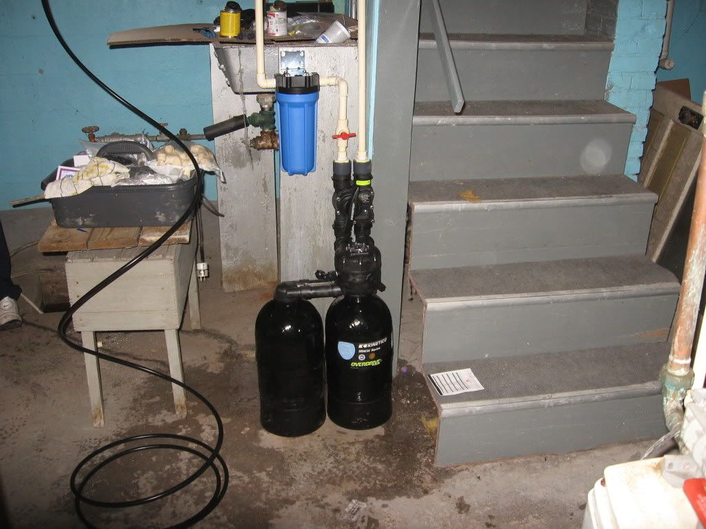

The Kinetico models 2020, 2040, and 2025 will all be excellemt for you use. The tallest one is 25". They all will work well withn your water conditions.
The 2020 is a cabinet model, the other two have a separate brine tanks. All are very highly efficiency. I can send you specif details on size and performance if you like.
They are non-electric, so you don't have to worry about rewiring anything. They are twin-tank so they give endless service even during rengeneration. All-in-all, a very good choice.
