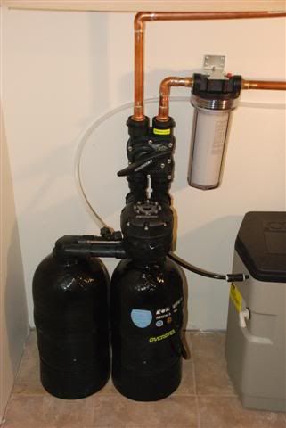

We just have the 2040SOD Softener installed last night.
This morning when I went down to the basement to double check for leaks, I have noticed that there are arrows on the head unit for the two big intake and outlet ports.
But the interesting thing is ..... the hard water (outside pipe) is now connected to the port which has an arrow pointing outward from the center of the head unit. the pipe leading to the rest of the house is connected to the port which has an arrow pointing towards the center of the head unit.
So the water flow is the opposite of what the arrow are pointing.
I would think that the port with the arrow point towards the center of the head unit should be the inlet port ?
Could the installer did it the wrong way?
Is it something that I should worry about?
Water seems to be running fine inside the house, but the installer didn't test the water after the installation, so I am not sure if the softener is doing anything.
I have took some pictures but I am not sure how to post them here.
Can anyone with 2040s check to see what port is the water source connected to? Does anyone have an installation manual that can share?
Thanks.

I am willng to bet there is a Kinetico by-pass above the softener, right? These are designed to be reversible for easy installation and to avoid criss-crossing pipes. This is a common question and a big mistake when home owners move the softeners to a new location and use the arrows for installation.

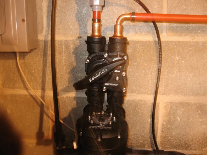

So the arrow is in fact correct. But it is the by-pass module who have done the cross-over of the flow. Interesting.
Anyway, here is the photo of my setup ...
And here is a closeup of the water flow arrows ....
You can see that my water source (input) is now connected to the right hand side of the by-pass module, and the treated water are coming out from the left hand side of the by-pass module.

Yes, the arrows can throw you off but as I explained, Kinetico's by-pass accommodates for varying plumbing locations/directions. The by-pass can be located remotely from the softener as well.
All dealers and service personnel should have the functions and proper operatins of their equipment as a high priority if they wish to be thought of as professionals. I find the fly-by-nighters and on-line dealers are more interestd in the sale than the service. True you can find the opposites in both.
Even with full service manuals in hand, I have seen homeowners really mess things things up. On the other hand, there are those that can take it apart and put it back together with little more than their good mechanical sense/memory.
Let me know if you need more information.

Based on the explanation from Andy, the Kinetico by-pass module is capable to channel the water flow either with a straight-through configuration or a cross-over configuration.
And in my case ... based on my understanding now.... the hard water coming in through the top right connections is being delivered to the bottom left connections when exiting the by-pass module and therefore is going into the softener in the correct inlet port.
Now that I understand how it is configured, I actually think it is a pretty smart design. But I also think that it would be nice if there is something on the by-pass module that clearly indicate what is the current configuration (straight-through / cross-over)..... even a simple sticker will do.

Very good explanation. The arrows are on the valve and are always intended to be followed.
The by-passes usually come with a sticker that says A-C as default setting. Installers all know this. It would be a yellow sticker on the B port.
