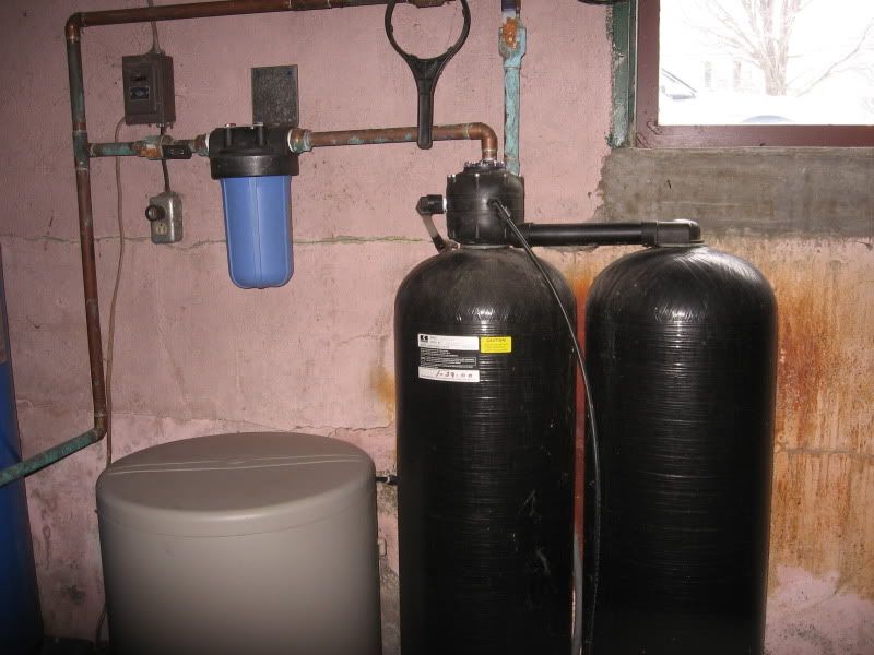

I stop recommending K-100 (MACH 2100) 85 grains CH and above. So no, don't get the K100, with more resin even if it is a fine mesh resin. Your iron is too high and will cause problems in the future. Adding more resin and regearing is an in-shop remedy and may work in some situations, but with water like yours (whew!), it is taking a big chance.
I can send you details on settings, capacities and controls if you like. Get the new unit and feel assured.
K-100 gas 1.5 cuft in each tank; the 2175 has 2.25 in each tank.
I hope you are planning on getting an RO as your sodium levels will be VERY high.

Yes, the 2175 will work wonderfully.
Goind witn the magnet, EasyWater,. salt-free softener will be disasterous. I would avoid them completely.
An RO uses a membrnae technology to remove dissolved solids down the molecular size of H2O. Very effective. Kinetoc makes the K5 model which is very good and has a very cmprehensive warranty.
Can you describe the odor you have? Rotten eggs or old, wet, smelly tennis shoes? Did they describe the chlorination system at all?

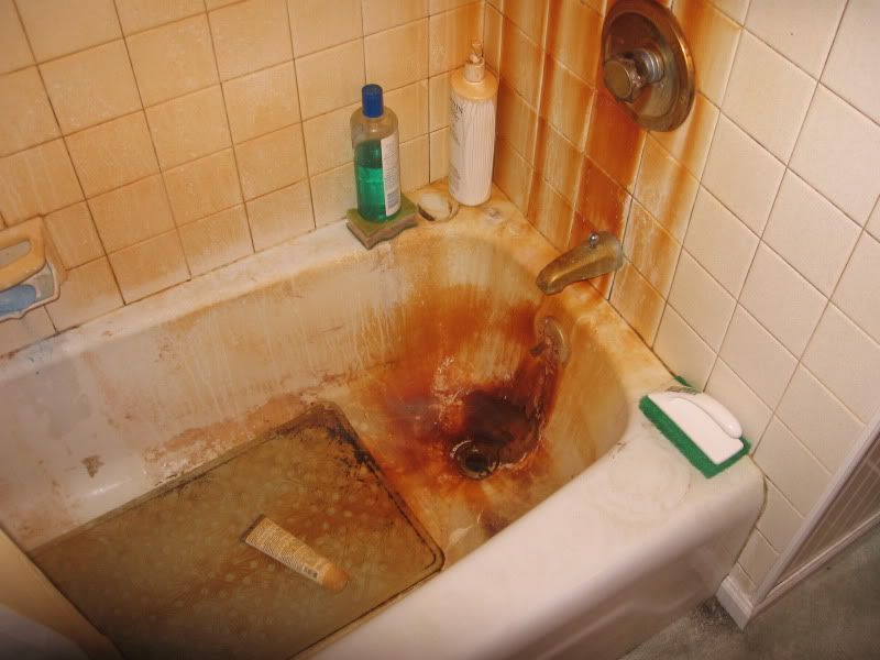

With a family of 7, your water use will be quite high. An iron filter that can also handle the sulfur can greatly benefit your set up. This will make the softener work more efficiently. If you use a chlorinator, it will require a large retention tank (at least 120 gal.) and a backwashing carbon filter.
Aeration will be over taxed. I have never worked with a Filox system and don't know how much sulfur it can remove in conjunction with removing iron that high. Do you have sulfur numbers?
No one needs water 7/24 and that is never the reason for getting a twin-tank system even though it can do it. It is the other benefits that provide great results.
I would only recommend a lower salt dosage if iron levels were low. At those levels, a higher dosage would be needed.
There will be days where more water is used than others, of course. Do you have a submersible pump?
This was install about ten years ago on 95 grains and 4.5 ppm iron. It is serving a family of four with weekend guests (grandkids, etc.). It is doing a fine job with no stains. The prefilter can help with sediment. The old softener leaked badly but I don't know why.
Iron can cause a major problem. This place had 5 ppm iron and 115 grains hard. No sulfur. A 2175 works very well.
Mind you, whatever system you use, you will have a large salt usage and the Total Dissolved Solids (TDS) will be very high. This water will not be drinkable. +This would be another reason to have a seperate iron filter ahead of the softener. An RO will be needed if you wish to avoid bottled water in great quantities.

(Bob) If the conditions are the same--comparable resin in each system--a twin-tank system--Kinetico or Fleck--will have an advantage because it can/will be set up to regenerate when the resin is exhausted.
That was the original intention of Bill Prior and Jim Kewley when they invented the twin tank design. So, if the softener is due to regenerate at 10am, noon, 3:46pm, after dishes are washed, or while you are doing a loads of whites, it just resumes into its regeneration and switches tanks and continues it softening ability without a bleep, each time getting maximum efficiency. In fact, a twin almost never regens at the same time. Consistently inconsistent.
Of course, no one really uses water 24/7 in residential applications so that is never a key point, albeit true.
Another key point is that there is no reserve capacity which, on a single tank, is rarely ever realised to its capacity and more often either regens too early--wasting salt/water, or too late permitting iron to emerge into your plumbing, water heaters, dishwasher and laundry; not all the time but it can happen and with 7ppm iron it WILL be noticable. For a demand system that is predicted to regen almost daily, that further increases the risk of mssing the mark.
One of my favorite features and associated benefits is that the twin regens in softened, iron-free water. When you reg a softener with 105 grains plus 7 ppm iron, especially with a 110,000-grain unit, the resins begin to decline in quality much faster and fouling is much more likely.
With a single tank system and regeneration only at night there is inevitably some wasted capacity with translates to increased water usage when measured on the basis of gallons used per 100,000 grains of hardness removed.
A unit this size needs to have a reserve capacity, normally set to accommodate enough water for one-day's use by all individuals. If only half the capacity is uses due to low usage one day--and it doesn't kick into regeneration at 2am, and the next day higher water demands are needed, it is a very good chance that the resins will become exhausted prior to that pre-set regeneration cycling time. A twin is designed to prevent this all the time. My feeling is: the worse the water, the more a twin is beneficial.
