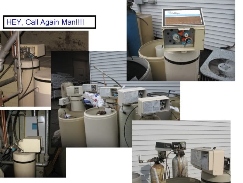

Sorry to have kept you waiting...been very busy this month
Culligan offers three ranges: Medalist, Gold and Platinum series. Not sure of their philosophy of offering their lowest model unless comparing prices of thie own units causes one to jump at the economical ones. Here is a review of their line.
CULLIGAN - medallist series water softener system
I often find myself explaining their equipment more than their sales' staff. That's OK because I feel Kinetico has great equipment and many features and benefits of Kinetico units are excellent in comparison.
Don't get me wrong, Culligan is bigger, older and more famous company. They have a long line of happy customers and can be termed a successful comapny. I have come to understand it them from a different point of view and that is mostly what we remove from homes. Below ar some examples. The middle picture is of six units we replaced in one week.
If you decide to go with them, then they SHOULD serve you well. Understand fully, though, their warranty and their service programs, salt efficiency (Medalist vs other units), etc. Educate yourself and you should expect decades of great water from whomever you choose.
