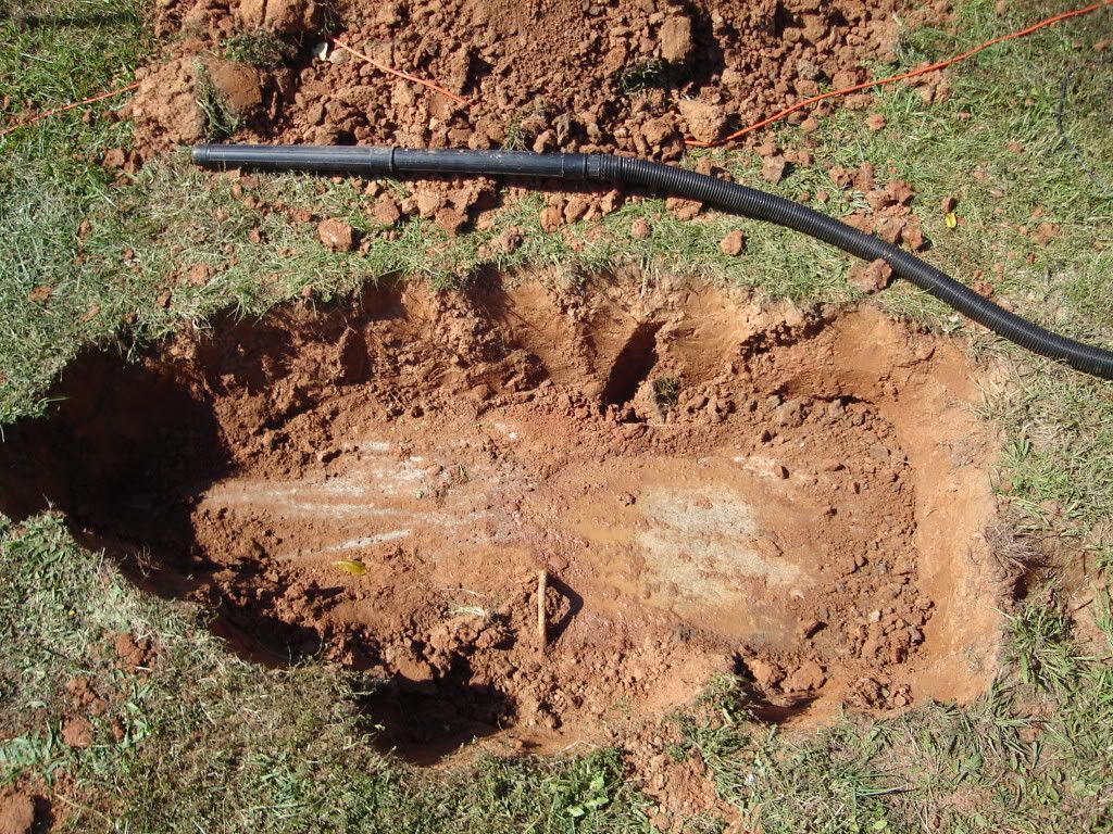

I have included a picture of what I have dug so far. I'm tired. I am pretty sure I found the septic tank but I can not find a access to it. Any ideas?

That metal ring sticking up looks like the lifting handle for the cover. The cover is about as big as your hole. If you dig outward a little further you should find the edge of the cover. Hope you had your Wheaties foday cause they aren't light.

How deep is the lid, because I went down about a couple inches and didn't seem like there was a seam.

Some tanks have small access holes while some a big section of the lid lifts off. The smaller access holes are about a foot square and weigh about 30-40 pounds. If you have the bigger type... I hope you have help or some diesel powered machinery.
To answer your question. The lids are about 3" thick.
Be careful when lifting the lid by the re-bar handle. They rust after years in the ground and have a nasty habit of snapping at the worst time though your's looks to be in good shape. Make sure to keep your feet out of the way.

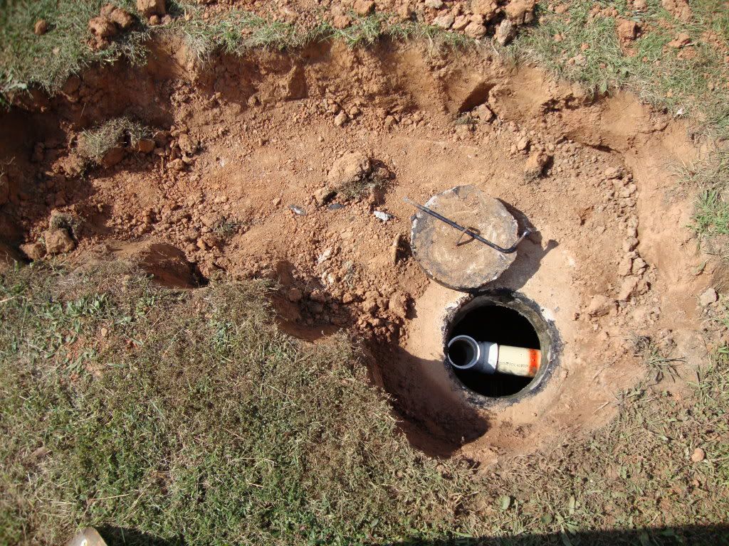

Ok, So I dug some more. I think I found the pumping access lid. There is only one, right?? Is it normal for it to have something like tar sealing the lid?

The number of lids depends on the tank. If there are separate chambers or large baffles there will be a lid for each chamber so you can get access to the entire tank. If you only have one partial height baffle at the top of the tank it is possible you only have one clean out though two is more common with one at each end. Usually they are close enough to the end that you can reach in to where the inlet and outlet pipe pass through the tank wall.
Lids are often sealed with tar to prevent ground water from entering the tank. No sense in running rainwater through your system. You may have to stick a pry bar in the crack around the lid and break the seal. Just lifting by the re-bar handle sometimes breaks the handle.

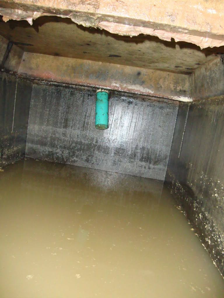

Well apparently from what I was told from the Septic guy, that having tar to seal the lid is very common. He did have to use a long pry bar to lift it open. I included photos of the lid being off and a photo of inside the tank. I just wanted to know before I dug some more. Apparently my tank had never been emptied in the 13 years it was installed. Can anybody tell if there would be an opening at the other end?

There is usually one at each end, near the inlet & outlet. The other should be close to the green pipe just like the one you found but at the other end.
