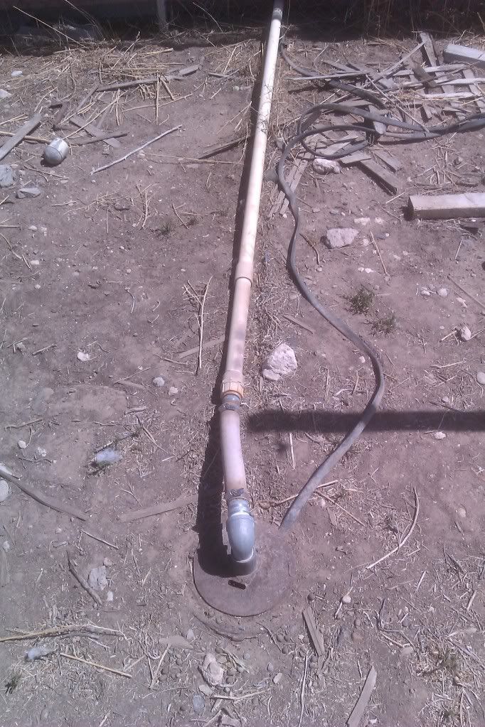

Ok, the picture helps me a lot. I want to pull it myself, but I had some concerns. After looking at the picture, I don't think I have a pitless adapter. I will try to get a picture of the setup when I go home at lunch so it will make more sense. I also figured out over the weekend that it is 1 1/4" PVC down to the pump. I am trying to find a plate to use to to hold the collars as I bring it up.
Question: Should I use a belt wrench to unscrew the sections? I would think anything else would bite into the PVC? Thanks

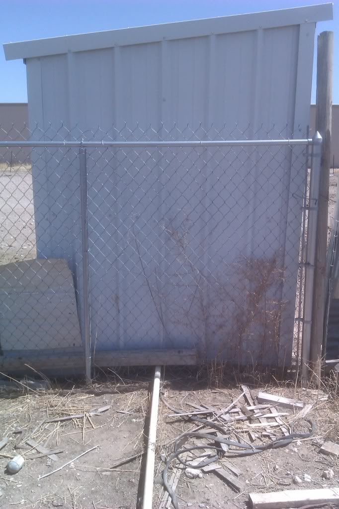

This is a picture of the well house on my neighbor's side. You can see the 1 1/4" line coming out of the well house. It is coming to the well which is on my side. After looking at the picture you placed, that is why I don't think I have a pitless adapter. I'm thinking, (and please tell me if I'm wrong), that I would just need to have the plate to hold the collar as I unscrew the sections. My neighbor did tell me that he remembers the well guy taping the electric line to the water line to keep it from pinching from the torque. Maybe this will help.

weird how its flush with the ground. have you tried to lift it by hand any? might not need anything to rest couplings on if its on 60' pvc. might just lift it out and arch it over good until you get it all out. keep your face out of harms way. get a descent well seal to replace the plate.

It makes me very happy to hear you say that! After I saw your picture, I really did have much more hope that it might not be as bad. If you think I can just arch it, then that is even better! Thanks so much. I will repost when I get it out to see what ya'll think.....and then for the return as well. Than ks again.

Mission accomplished!! Ya'll are amazing! I'll attach a couple of pics. First of all, the neighbor misremembered. The well was 120 feet! We started getting wet pipe at about 40-50 ft. We pulled it by hand and we took it over the well house like you said. It was easy at first, got brutal in the middle and finally eased up the last joint and a half. When we finally got it out, it was nasty (rusty, etc). I started looking at it and I saw a couple of wires that looked like they burned off. When we finally separated the pump from the motor, the picture shows what it looked like. One side burned half off! The pump guy that I took it to said that in all of his years he had never seen one do that before and he had no idea what could have caused it. It was locked solid! He said they were 23 years old so someone got taken somewhere along the way before I got here.
So, I got a new motor, pump and control box together for $419. He also said that they had put the torque arrestor too close to the pump. It was a foot away and he said it needed to be 6-8. I heat shrinked and Scotch 33+ wrapped the wires. We started it, and it ran fine, but not a lot of pressure. We couldn't figure out why until we saw a big pool of water. Evidently, the guy that put septic tank in had hit one of the raised sprinklers and broke it completely off. We turned that valve off and had great pressure!
So I have two breaks to fix and one mysteriously capped line going to my front yard sprinklers, but we have water!!! So where my first post said I am a novice, I am way past there now. And with my neighbor splitting it and my brother in law and neighbor helping me. It cost $243!!! Thanks again!
