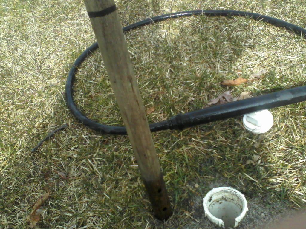

I am not moving off the 9" mark. Back in December I was at the 16" mark or so. So I am makeing progress IMO.
I started aeration Jan of 2012. So its been a little over a 13 months. I believe my level is now at the very bottom of the first side holes is my tank. I assume these tanks do not perc well from just the bottom area.
Here is my tank with where I think I am at the 9" level because the side holes dictate that. This is a old pic of when I had the tank originally exposed.
Here is what I dipped at today. Again 9". Took two showers this morning, so I think the water is just going right out the side discharge holes and my clogged rocks around the pit are now aerobic and cleared.

But to go back to my week three of aeration I was down to 3" or so. This is baffling to me why I raise back up to the 9" mark? Im not complaining just wondering....
This pic is from week 3 of my aeration process back in feb 2012. I went from 18" to this mark in 3 weeks.....

Hi all.
I thought I’d give you the benefit (!) of my experiences having followed some of the suggestions and experiments on this very useful thread. I’m based in Ireland but for convenience I’ll use mostly US references/conversions. My report is long and may not interest any of you, but here goes anyway.
My septic tank is concrete, two-chamber, with capacity of 1300 gallons. It serves five people (three teenagers!), with no separate disposal for “grey water”. There’s no run-off from roofs or yard going to the tank and we have no garbage disposal unit or power showers fitted. Based on typical water usage in this part of the world, I estimate about 200 gallons per day goes to the tank.
My drain field was installed in early 2011 as the very bad-quality original had failed and there was rising effluent in the garden. Properly-drilled 4” PVC was laid in ¾” washed gravel in three 18” trenches giving me 150 feet of field. (Ideally, the drains should be bigger but space is scarce- I could squeeze another 50 feet in at a push and I might do that yet). A textile cover was put over the gravel to prevent soil infiltration. A distribution box was installed and is readily accessible. Unfortunately, no filter was put in the outlet at this stage- they’re not common here yet.
Everything worked well for about a year and a half, with no obvious back-up at the distribution box or tank. I noticed that I was starting to see high water in the box in mid-2012, and when the tank was pumped then there was some water coming back from the field. With no real understanding, I did not investigate further at the time.
By November, the drainage from the house was very slow and I had to call the pumper again. The system was completely backed up and there was a surge of material from the pipe into the tank as well as significant run-back from the field. 2012 was a very wet year here and this did not help, but I knew I was in trouble.
To add to the problem, we have had to register our septic tanks and an inspection regime will be in place in the near future. The inspections will target vulnerable groundwater areas initially, as water supplies, particularly wells, are being affected. Luckily, there are no wells or water abstraction points around here, so I am not expecting an inspection for some time. But I wanted to get things working properly anyhow.
We were away for a couple of days in early December and I noticed there was a slight fall in levels in the tank, so there was some percolation; but clearly not sufficient to cope with daily demand. So after a lot of reading about septic aeration and related products and using the advice on this site and others, I decided to try to retrofit an aeration system just before Christmas. Over here, there appears to be little or no market for the add-on aeration systems widely on sale in the US, and I could not source anything locally. I didn’t try importing one due to different voltages and high postage and customs charges. As I’m reasonably handy, don’t mind getting dirty and relished the challenge, I opted for a home-made solution.
Firstly, I cleaned the drainage ditch that runs alongside my garden and removed a lot of leaf debris to get a decent flow going. This had the effect of dropping the level in the ditch (and presumably the water table around me) by about four inches in a couple of days. Then, I bought and fitted a bristle filter for the tank’s outlet tee. Next, I purchased a 25 litre/min air pump (just under one cubic ft/min) with airline and two air stones. I purchased additional air stones separately as the pump manifold can supply six lines. I ran the cable for the pump underground from my shed to the tank (in heavy-duty plastic protective pipe) and wired it up to include a switch and circuit breaker as recommended. The 20 watt pump runs permanently.
On start-up, I had good movement in the outlet chamber and after a day or so a three- or four-inch layer of white bubbles which soon reduced. There was a smell which got less noticeable over a few days. We changed our water usage habits to avoid overloading the system, particularly on laundry days. But after a couple of weeks I was not seeing any fall in levels and I was forced to drain off some effluent to the nearby ditch (on several occasions) to avoid backing up again. Obviously, I was not happy to do this but I could not afford to get it pumped again.
Over the next few weeks, I worked on my system on a trial-and-error basis to try to get better results quickly. I flushed the lines with the garden hose and got out a lot of standing foul water and slimy black floating material (bio mat?). I moved the air stones about in the tank to the best location to avoid stirring things up too much and to get the best distribution of air bubbles. I put in a couple of 4”, 90˚ bends in series below the outlet to act as a sort of “settling chamber” for the effluent about to leave the tank. I placed a small rubber fine-bubble diffuser directly in the D-box to give a ”final” blast of oxygen to the effluent (but this blocked quickly and was later removed).
Eventually, after about five or six weeks, I had some progress. The level in the D-box would drop about an inch overnight and I did not have to release effluent to the drainage ditch nearly as often. I tried replacing the air stones with lengths of ¾” PVC pipe with multiple 0.4mm holes drilled in them, but this was not a success. In the end, I purchased two 12” rubber diffusers which I set up horizontally in the tank. These are much more effective at producing small bubbles and less likely to get blocked and easier to clean even if they do.
Now, five months after I started, the effluent is clearly soaking away and most mornings it’s near the bottom of the outlet pipes in the D-box. Long-term, I’m confident the drain field will be fully restored. I’m still wondering if I undersized the pump a little and might get a higher output one on replacement, but I think nothing much bigger is required once you get good levels of small bubbles forming. I’ve replaced both crumbling concrete covers over the tank with galvanised ones, and made up a chamber with an old sewer box and a plastic bucket that allowed me to put the pump below ground level so everything is nice and flat in the garden.
As of now, I’m a believer- restoring a failed drain field by aeration does work. It takes time but it absolutely does work.
I hope this helps someone out there.

Grizz1943,
I have been following your exploits on this thread and your Google page- sorry to hear you've been having such bad luck.
In my case, it's steady-as-she-goes. I've had no back up for some time and the drain field is just about able to cope with the volumes. I haven't had to drain off any effluent either.
I agree about aeration stirring things up. I can see this clearly in my second (aeration) chamber. What I've done is to add a U-bend to the bottom of the filter pipe/outlet and brought a 4" pipe up to above the waterline. I drilled a few holes at the waterline in one location so the effluent can get away. By careful placement of the diffuser, the air bubbles rising force any larger material away from the holes, but water pressure allows effluent in as needs be. Obviously, very fine material can still get in with the effluent but the filter will catch much of this.
Samples I take are free of large floating matter, but occasionally I might see one or two very small bits. The effluent is not crystal clear, but is off-white or slightly cloudy- definitely not brown or darker.
We were away last weekend so there was only one person in the house- when I checked the D-box on my return, the effluent was right at the bottom of the drain field pipes- this is a first for me. We're having a bit of a heatwave which helps I'm sure, but it suggests my system is well restored and I need a bit more field rather than anything else.
I did reintroduce a bubbler in the D-box and this is helping in my opinion. I reckon it keeps the effluent "aerated" if flows to the field are a bit slow due to sheer volume. I think I will need to get a bigger air pump, as the current one struggles to sufficiently aerate when there is a surge due to dishwasher/laundry/showers (which I try to avoid but three teenagers....).
I checked the filter yesterday and it was not clogged at all, but I am familiar with your description as I was experiencing the same thing in earlier versions of my project.
Ideally, I would increase my field size and install a separate aeration chamber, but for the monent, it's going well. I'll update this in a couple of months.

Just an update. I had my septic tank pumped after 4 yrs. After it was pumped I added two bottles of cessflo from the home store to the seepage pit...
Here are the results of the depth. I have been well below the 2 ft level since I started this aeraating test. This measurment was 2 weeks ago..
I have to note upon pulling up the hose with the air stick I developed a leak in the line. Seems the hose that sits in the pipe gets dry rotted somewhat and brittle.. I had to cut both ends clean and add a barb fitting to rejoin. I almost lost the air stick down the tank.
I will go out and measure again in a moment.
