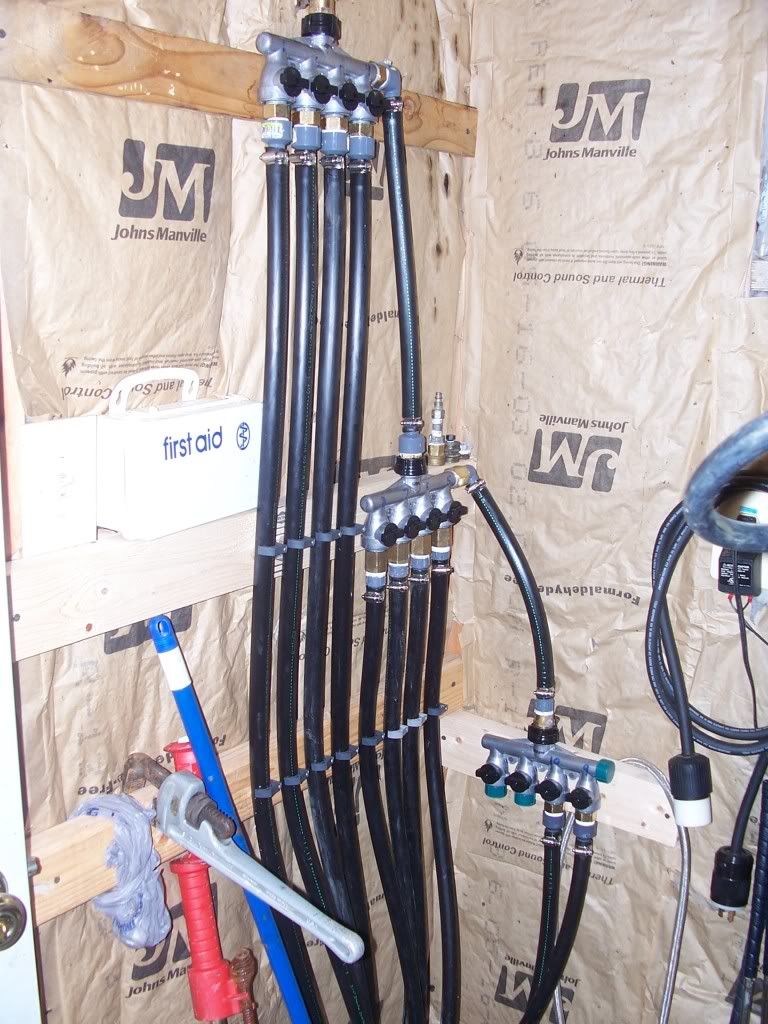

I would zone it at your 10 gpm. Thats how I did mine. I ran 3/4 pipe to each zone. I only pump 5 gpm at 55psi and have one head for each zone. ( Except a strip and the garden) I have rotors at 4 gpm that spray 35 ft or so.
I dont know what heads you want to use or how far you need to throw, but this helps you determine what you need to use. Toro, hunter, rainbird offer different heads and nozzles. They are all somewhat different.
Here is my budget install. Cost me $200 in parts and my labor.

Example: I can run two heads at 40 psi/about 8 gpm. They do not shoot as far. I can run one head at 55psi/about 4 gpm and they shoot the full distance. ( The nozzles are 4 gpm )
If you have 10gpm at 55 psi size you heads for 3 gpm each. 3 heads on a zone. Say using rotors for a far throw.
On one of my strip zones as in the pic I used sprays. I run 6 on that zone at .6 gpm. .6x6=3.6 gpm total. This keeps me at my 55 psi@ 5 gpm without the pump shutting off.
In conclusion I sized all my zones for 5 gpm@55psi and the pump never shut off.
You should size your zone to the 10 gpm you get at 55psi. You can use more heads them me and water your area in less time. This will save you electric and time.
To water my lawn each zone I run 10-20 minutes. Thats about 4 hours it takes to water using 11 zones.
My therory and thinking with the ones head each zone that I have is I use less heads. If I used 40 psi to run two heads I would need additional heads. ( Remember I hand trenched all of this) I was looking for maximum throw and coverage, plus maximum gpm I could get on the lawn.
Also to reduce any friction and pressure loss I ran 3/4" home runs to each head. I have no 1/2" at all.
