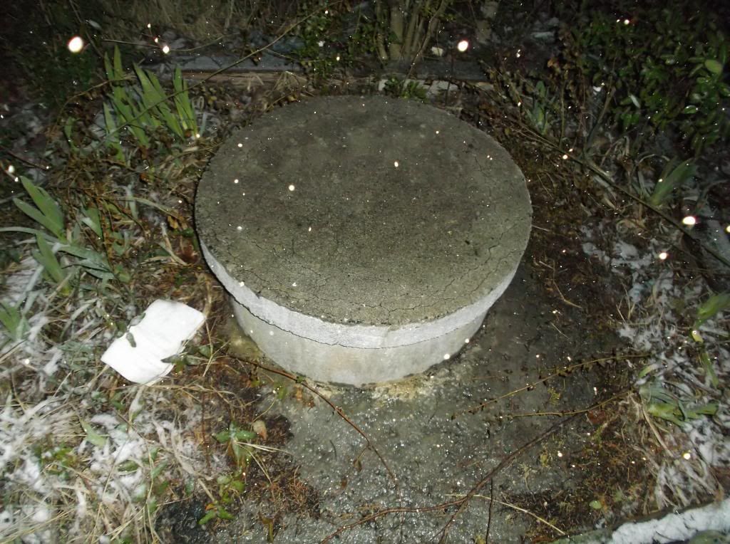

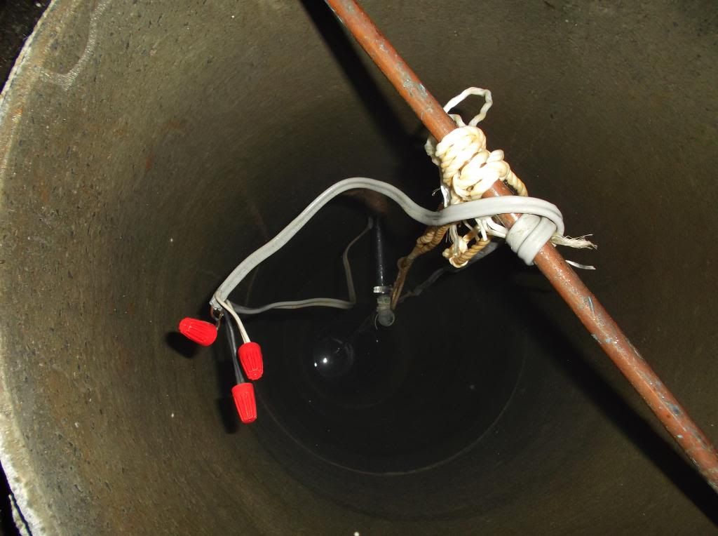

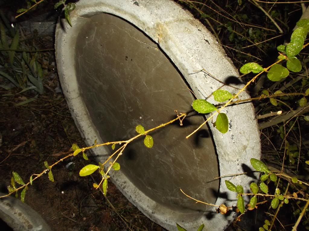

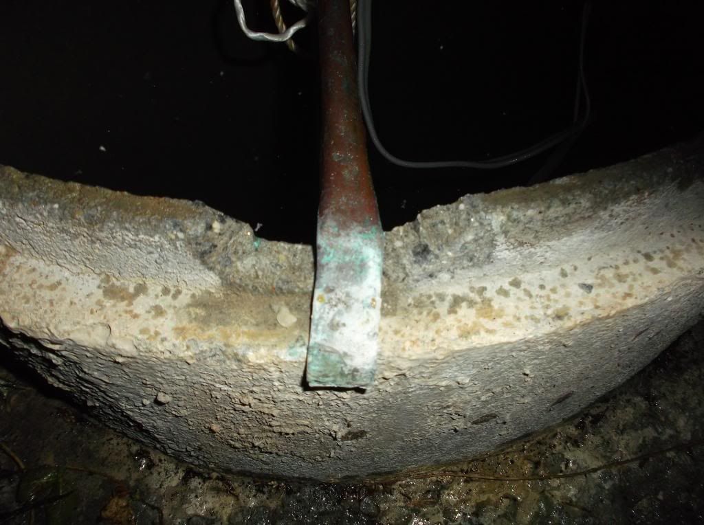

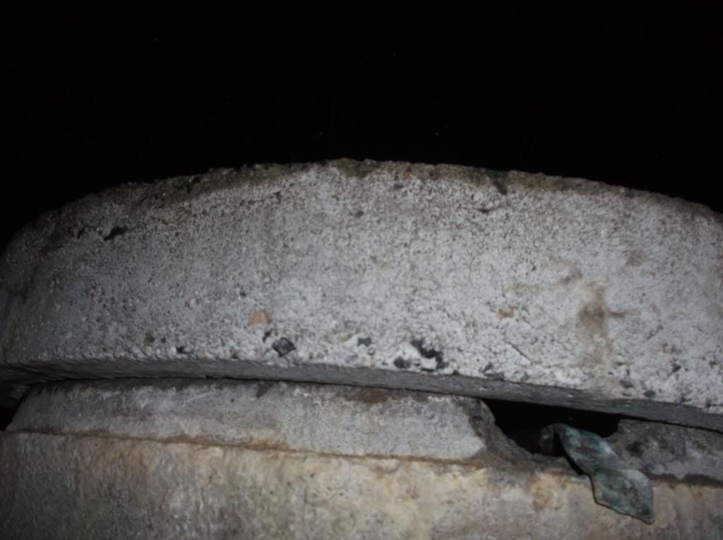

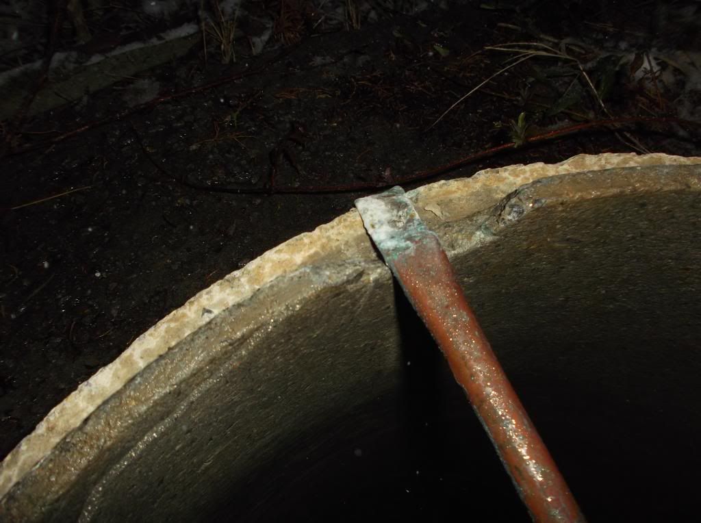

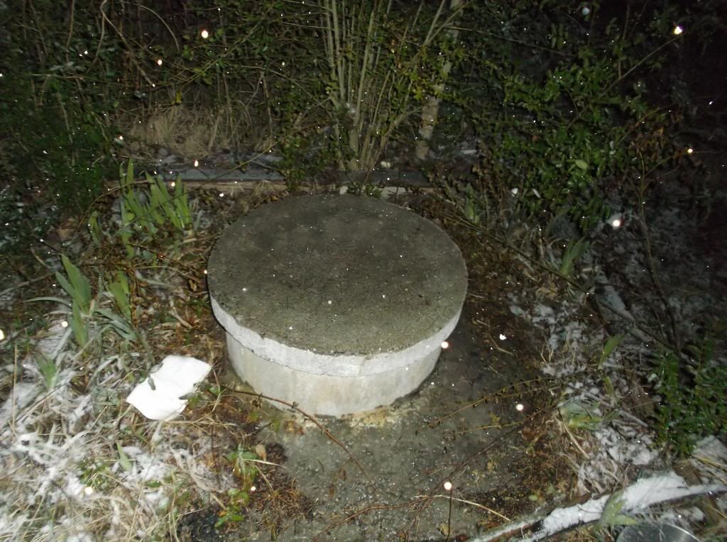

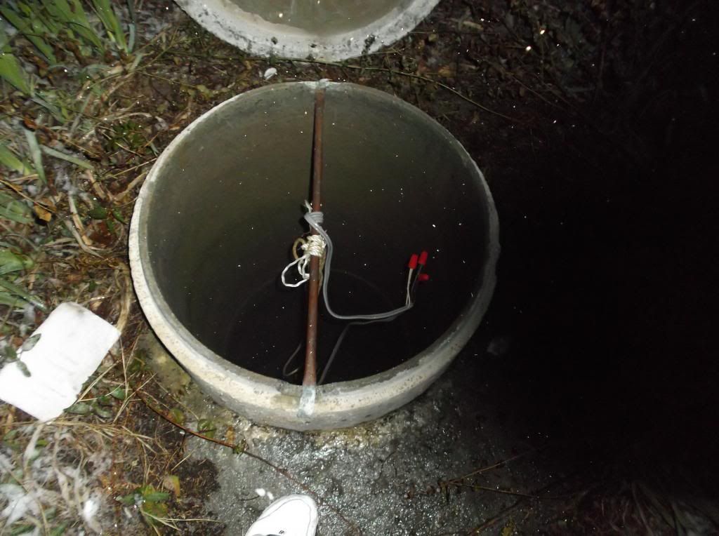

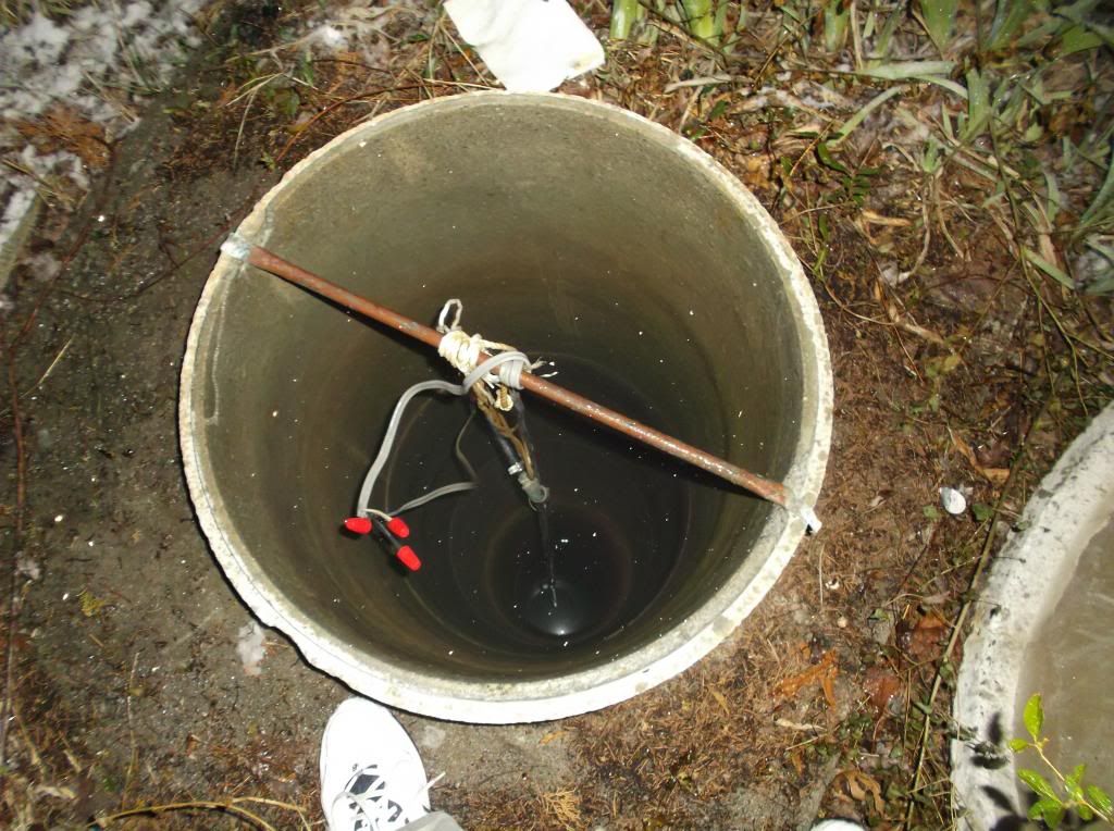

As requested....it was snowing out....

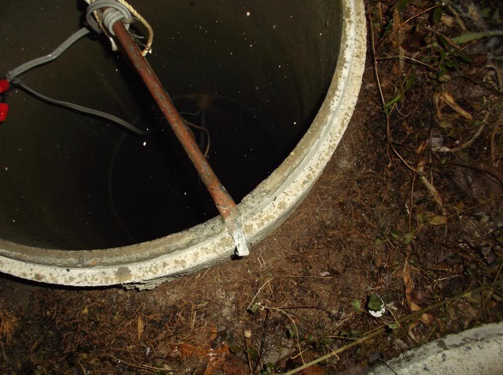

The square concrete slab area around the well (someone please give me a name for it) extends about 2 feet outside of the casing and is pretty flat and intact. It just happens to be pretty dirty due to there being a tree on top of it which drops debris all over it and is too expensive and large to cut down.

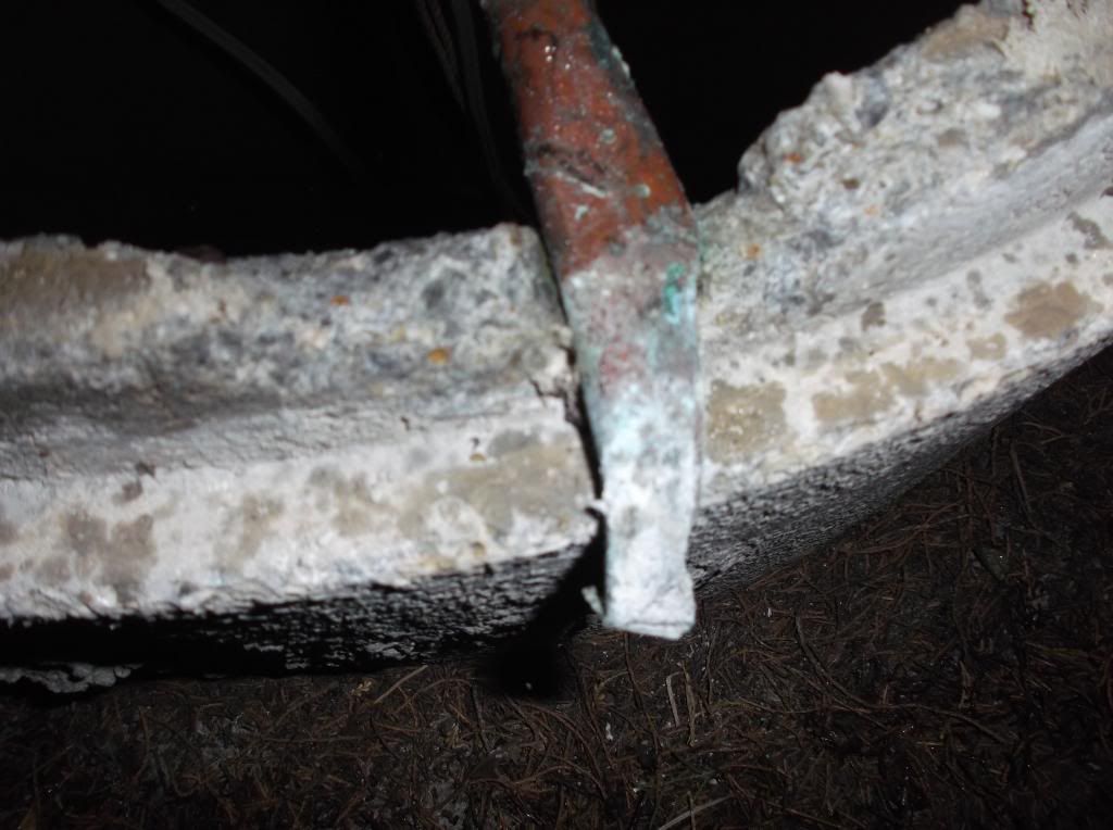

I think that my problem is pretty obvious as you can see below but I am scared to do crappy concrete work and have it just chip and fall off anyways.
Steel wool in those areas? I don't want to draw conclusions spend eons fixing my problem only to still have mice coming in from some unknown tiny crevice.
I think the barrel is still my best bet in that case.
Thoughts?

I have/had a well similar to that on one of my rental houses. It too had problems with mice squeezing through the gap between the lid and riser. Also, there was no pitless adapter like yours and the only way to access the pipe connections was to winch someone down the hole. I ended up having a new well drilled to avoid the maintenance and safety problems.
In you're situation I might try getting steel wool like used for wood working. Unravel it and form a gasket around the top lip of your riser. Then set the lid down with the steel wool sandwiched in between. Mice will not dig or chew through it and it will allow the lid to be easily removed for servicing.

A pitless adapter is what should have been installed on wells like yours but unfortunately never were. It allows you to pull the pump or down the well piping from above ground while keeping all the piping well below grade to prevent freezing. It has a dove tail fitting & gasket that makes the connection for the water and there is a female threaded hole on top you can stick a male threaded pipe into to pull everything up for servicing.
The well on my rental house in addition to mice falling in the well had the foot valve down at the bottom of the well fail. No plumber or well company in my area would send someone down the well and I was not going to hang by a rope down in the well 20' above the water so a modern drilled well was one of the better options... if you forget the cost.
Use whatever steel wool you have. You can use double sided foam tape or glue to hold it in place. I unrolled a bunch of steel wool. Ran a bead of caulk around the well casing top and then stuck a good sized "worm" of steel wool into the caulk. Then sat the lid on top.
Thanks for that. I set the steel wool in there but before you posted I just wedged it in there. I don't plan on removing the cover much anymore since everything is now sitting pretty nicely with no visible room for intrusion. I guess I have to remember to use some long nose to pull it out before I lift the cap again.

get a can of that expanding foam stuff they sell at Home Depot for sealing up air leaks around door sills/ windows.....costs like $7 and is in the area where they sell doors.....shoot the whole gap between the existing concrete pieces....you just have to redo it every time you open the cover (but that should be once every 5-10 years)
