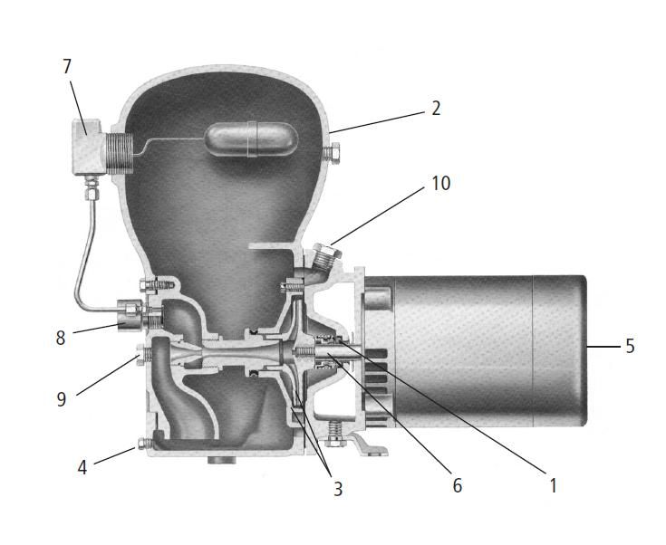

I have this ancient "Balanced Flow" pump at my cottage:
It works fine and I have an unused spare just like it. I've never seen anything like it before. The alien-looking bulged head is a built-in small storage tank. I have 2 questions about this feature:
Can I add a larger bladder tank after the pump (to replace the tiny 5gal one) without causing cycling problems?
There is a small box on the front of the reservoir that's described as an "air volume control" and inside it's connected to a float. I have no idea the purpose of it.

I lovingly refer to those things as "Watermellon Pumps". LOL. I don't know much about them. You should be able to add a tank with no problem. The AVC looks like an air release type. If you add the bigger tank you might be able to do away with the AVC. Good luck!!

But what does the AVC do? I've don't see one on other type pumps, or on a bladder tank, so why is there one on an integrated pump/tank? What does the float do in the middle of the tank--isn't it supposed to be full of water at all times?

An automatic volume control is only used on a non-bladder type of tank. I don't know how they work but they let a little bit of air into the tank if the water level is too high. The air rises to the top of the tank and provides a "cushion" the same as a bladder in the newer tanks. Without the air cushion the pump will short cycle.
In your case the automatic volume control is adding air into the "watermelon" casting. If you have this pump connected to a bladder tank then you don't really need the volume control but neither will it hurt anything as long as it isn't leaking.

If I disable the AVC will I need to move the pressure switch off the "watermelon" to prevent short-cycling?
This from a manual I found on line:
If it is working in an acceptable manner I would say to just leave it. If you are having problems then completely remove the AVC and plug any openings with the appropriate fittings.
Whether or not you would need to move the pressure switch depends upon the piping between the pump and the bladder tank. If you have a check valve in this line then I would suggest moving the pressure switch sensing line to the bladder tank.

Nah--no problem now. I just wasn't sure if having air in the on-board pressure tank would be an issue when I add the 20 gal. horizontal tank later. Would this trapped air cause any oxidation, bad taste or bad smell?
The pump has an included check valve (#8 in the diagram). The in-service pump has the pressure switch mounted on the back side of the "watermelon" (up in the air pocket?) but the unused spare has it attached to the motor, with a small plastic pressure line going to a port on the lower rear of the pump. Probably doesn't matter but I thought I better mention it.
