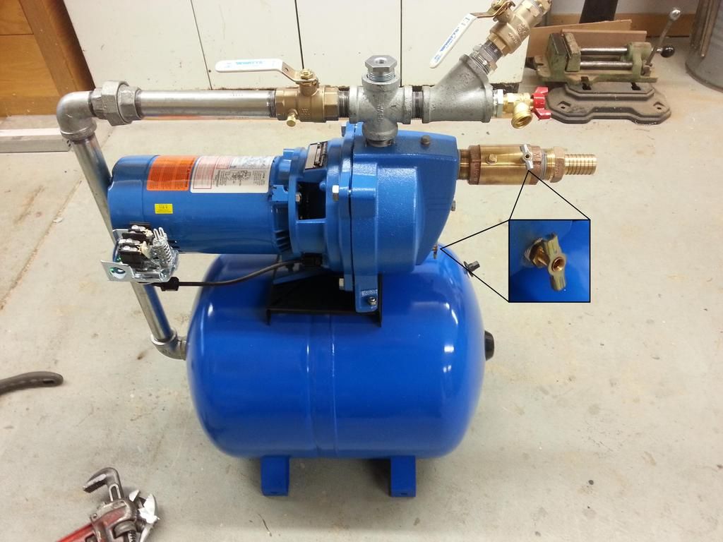

Am I asking for trouble using these drains?
Putting together a new shallow-well pump for my cottage. I want to install a couple easy-to-use air bleeds to assist in winter drain-down--preferably without needing tools. This is the only type drain I can find in small sizes but I'm not impressed with the quality. Do these close without drips & last a long time?
My previous cottage pump had some very nice all-brass bleeds with nice big wing-nut type ears. Kinda spoiled me.

IMO best to get 1/4" ball valve.
1/4 In Full Port Ball Valve
I had those type drains you show in your pic. They leaked and rusted so bad one broke right off.

Got a mess there.
No way would I be using galzinized pipe.
You have galvinized pipe in direct contact with bronzed ball valves, sure way to have electrolisis and corriosion.
All your fixtures, tub, shower, sink will have rust stains from that steel pipe.

How do you prevent freezing in that short vertical portion of pipe traveling upwards from the outlet of the pressure tank up to the horizontal section where you have the gate valve ?

Thank you Larry-- that does look like an improvement. Are they made in 1/8"mpt? Mine are all brass except for the handle, btw.
The words are GALVANIZED, ELECTROLYSIS and CORROSION. Also, bronze with steel will NOT be a problem. Bronze (or brass) valves have been used with steel piping for more than 100 years without problem. Where there IS a problem using bronze or brass valves is when you use them with steam, they simply cannot take the temperature and remain tight.
I DO agree that steel pipe, is the wrong material. I would suggest using all copper and with soldered unions.
Guy, those "valves" are probably okay for as often as you will be using them. You could just use pipe plugs or nipples with caps for as often as you will be draining the set. I'd keep a spare drain valve or plug nearby for when one might leak. You will pay a fortune for 1/8 inch ball valves.

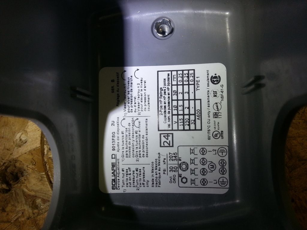

Anyone: my Goulds pump seems to have been supplied with a POS pressure switch. With screw 1 adjusted for the rated 30psi the best I can get for the cut-off is 42-- and that's with screw 2 bottomed out.
Any recommendations on a better switch? I want to run at 40-60 because that's the "sweet spot"in the pump curve (J5SH)

Pump, tank and curve are all checked, adjusted and good. Yesterday I was testing the unit in my driveway pumping from a 55G barrel so lift isn't the issue. I just can't get more than 12psi differential out of this switch no matter what range (screw1) or limit (screw2) setting. It's a Square Deal switch--which I thought was the best. Maybe they make a crap model in China or something.

Did you start out with a 40/60 Switch ?
Square "D" Pressure Switches are manufactured as 20/40, 30/50 or 40/60.
Except minor adjustments, you can't really change them from their factory settings. You cannot turn a 20/40 into a 40/60 without changing the springs to a different strength.

You should be able to adjust that pressure switch. Ive adjust many that were 20/40 to 40/60...
One screw raises/lowers both and the other adjusts cut in only..
The large one in center turns CCW to raise both cut in/out and same time. CW lowers the cut in/out.
You should not of had to touch the smaller one.
Your turning it the wrong way...

It does look exactly like that but the label directions are completely opposite of what you're saying:
The label directions do make sense to me in that increasing the spring pressure increases the water pressure needed to overcome it.
Regardless--I tried it all and can't build more than 42psi. It has to be damaged or defective.

I'm pretty sure it's a defective switch. It didn't start out with the adjustment bottomed out--it ended up there after I tried ALL adjustment combinations.
Looked all over online & made some calls to plumbing supplies. No US-made switches could be found so I bought another Square D FSG model (but 40-60), made in Mexico. Right out of the box it was set nearly perfect. Cut in was dead on at 40psi, cut out at 56...so I tightened the #2 nut a bit to bring it up to 60.
The only problem is the only 40-60 stocked at this supply house was a version with a low-pressure cutoff/manual start lever. I understand why but it's a complication I didn't want to deal with when explaining to guests how to turn on the water. If I wasn't in a rush to get this installed this weekend I would have ordered exactly what I need online and save a few bucks in the process.

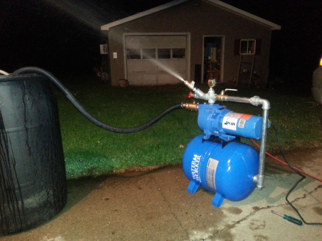

Anyways it works great and the 14gal tank gives the pump a nice long rest (compared to the teacup-size one in the old system).
Last night:
