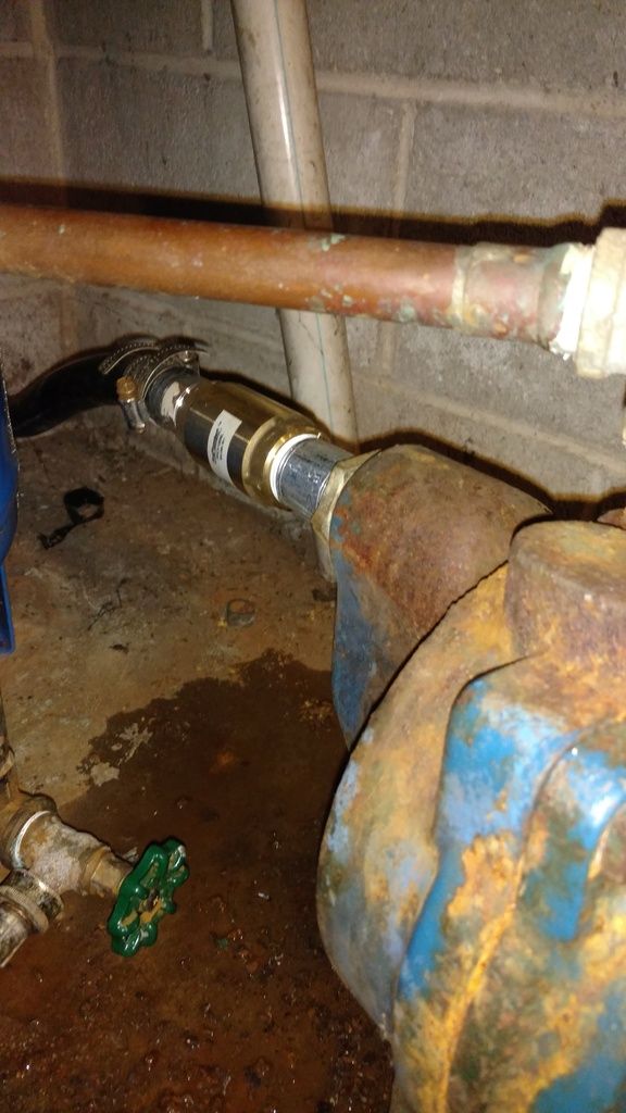

Ok heres an update. So I put the new 40/60 switch and gauge on and noticed there was a TON of blockage. Cleaned it all out and I couldnt get the pump to prime. I finally noticed the nipple attached to the line from the well was almost completely broke off so I went and bought a new one long with a new drain back valve as that was gunked up bad also. So now it wont fill the tank all the way. It puts about 5 gallons but the pressure gauge only shows 20 psi and the tank feels empty but I can drain about 5-7 gallons out of it but the pump wont kick off. I took a shower with the pump running and I had the best pressure Ive ever had but as of right now I have to turn the pump on and off. Any suggestions?

Ok so I took off the large plug right under the suction port and ran a coat hanger in there. It didnt feel like the wire went into a jet just felt like it was all open. Anyway the new gauge I put on was no good. I replaced it and the new gauge shows the pressure is 30-40 psi but now th epressure in the house is a lot lower for some reason.

The new gauge was junk I tested it with air. The pump is not turning off at all and now I have less pressure. It just hovers around 30-40 psi so something else must be plugged up. I took the line off that goes to the switch and its not plugged.

Now I think theres blockage going to the tank as it isnt holding much water at all. This has turned into a major pain

It was the jet nozzle. I ran a wire through the port and pressure went up. Amazon sent me the wrong switch so now I gotta replace that.
