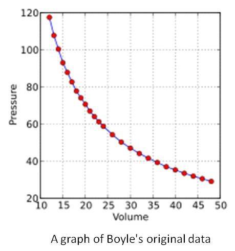

There is relationship between Pressure and Volume:
Pressure x Volume = Constant, that is, P x V = C
That relationship is a curve.
So the air pocket in the tank would be the V in the above, i.e., the volume in the above equation. When your system operates that air volume expands and contracts as water is used from the tank and pumped back in. If you set the air pressure with no water pressure on the air pocket, that is, no water pressure on the air volume, as you are supposed to do, then without water in the tank that air volume will be at some starting volume V. Let’s say V = 32 gallons and you set the air pressure to 28 ( 2 below the cut-in pressure of 30).
So P x V = 28 x 32 = 896 (i.e. P x V =C so for this curve the constant C = 896 ).
When your pump runs and pushes water in the tank, the air is compressed and the volume shrinks and the pressure goes up. There will be some point at which the pressure reaches 50 - the cut-out pressure. That point has to be where:
P x V= 896 that is where 50 x V= 896 ---- therefore V = 17.92 gallons when the pressure hits 50.
In other words, after you set the cut-in to 28 and the system runs, the volume of air goes from 32 gallons down to 17.92 gallons and back again in a cycle. So the amount of water you are getting between cut-in pressure(28) and cut-out pressure(50) is 32 – 17.92 = 14.08 gallons. That’s how much water you would draw from your tank between cut-out (50) back down to cut-in (28) pressure.

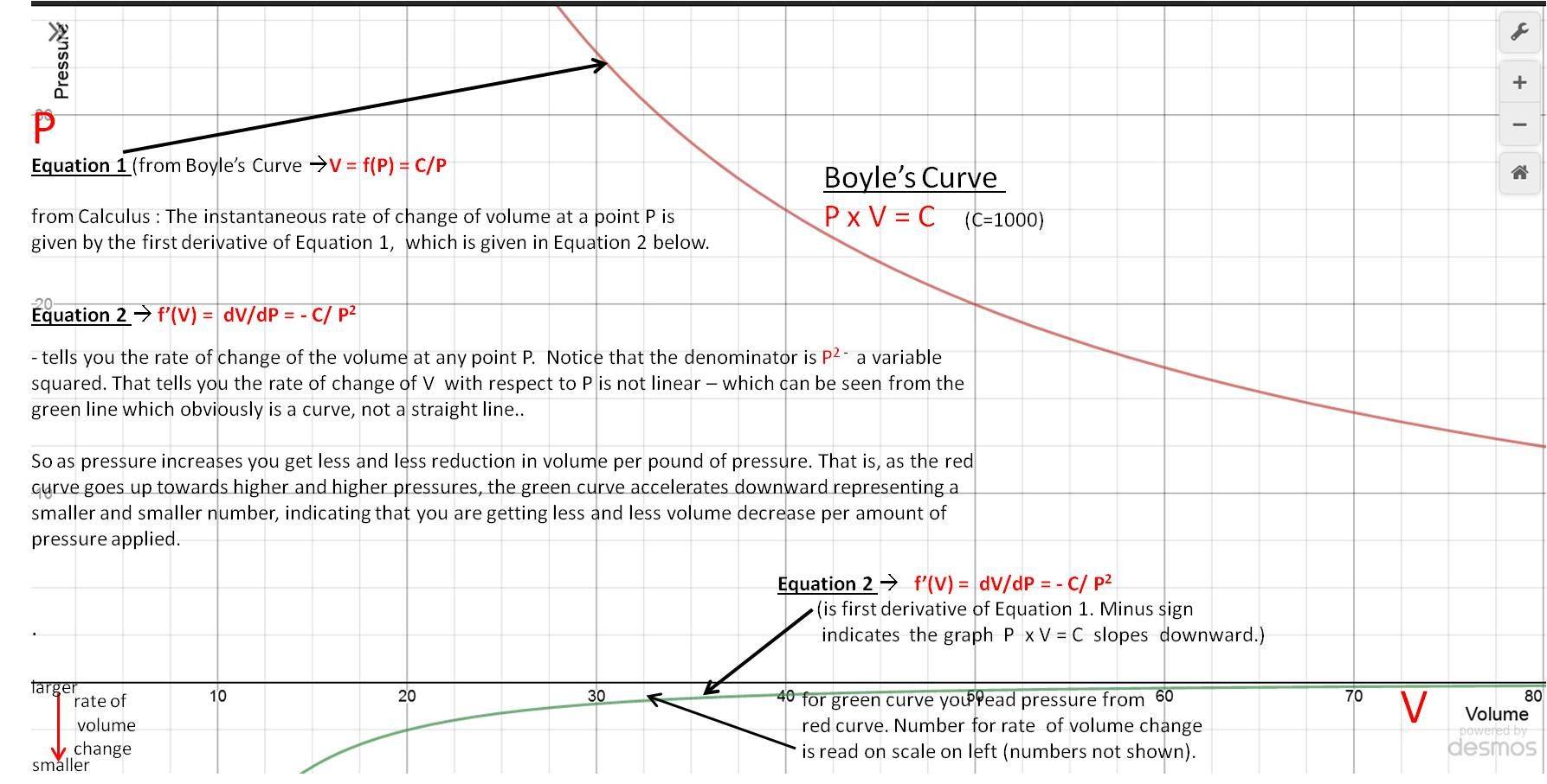

Um, actually, it's a straight line.
P x V = C determines the slope of a line.
P x V = C is in fact a curve. In fact, it is a very famous curve which describes a very famous law – Boyle’s Law. It is in fact expressed as a curve (a parabola). For example, this graph above is from Wikipedia – and from Boyle’s original data. You’ll see this relationship expressed that way everywhere.
If you mean you can plot V = C/P or P = C/V and get a straight line, as some prefer, that doesn’t change a thing. That just means some people like to look at straight lines instead of curves. It’s just an alternate, but less straight forward way of expressing the same relationship.
If on the Y axis you plot the variable “P”, and on the X axis you plot the variable “C/V” - you get a straight line . That just falls out of the equation P x V = C. It doesn’t add any new knowledge.
I think you will be extremely hard pressed to find a place where the relationship is first described as a straight line V=C/P or P=C/V. I doubt that place exists.
The reason I mentioned the curve in the first place is because I think the OP was confused on Pressure Volume relationship and I thought numerical examples would help. The fact that the constant was just made up (psi x gallons) I don’t think makes any difference in demonstrating the point – at least as far as I can see.

In practicable terms, the volume of water in the tank scales linearly, given the stated limits of 30 PSI and 50 PSI. Assuming the air bladder is 20" tall, then every 1 PSI over 30 will roughly correspond to a 1" difference in the level of water in the tank.
I haven’t done calculus for many years and at 76 many of my neurons have retired – but I think the above graph has it right – I think. Maybe it will shed some light, or someone who has better math skills will point out any error(s).

Unless the tank is broken that pressure will not go to zero nor will the volume go to zero. It’s designed to operate in a range of varying pressure (e.g., 30-50) and volume – but neither goes to zero. We are not talking about the physics and chemistry of gases in other environments. It is much simpler than that. You will be wasting your time getting out your chemistry notes.
The reason I posted the Boyle’s curve was because I thought that the OP seemed to think (I certainly could be wrong) that somehow if you lower the pressure by 10 psi while you were at some unknown volume, that somehow everything would self-adjust and you would still have the same volume operating range that you had before the adjustment. I thought Boyle’s curve and example would help clarify that.
