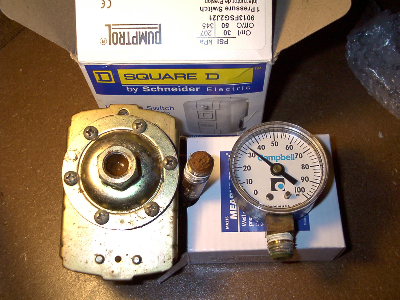

House water pressure (well) sometimes goes to zero for seconds before pump start

The newly developed pump-start delays have only happened for the past few/several months. I think that this is an intermittent condition (currently) because there have been times when I was using beaucoup water (washing clothes, using the garden hose, etc.) and anticipating the OFF when only a lessening of pressure occurred prior to the pressure picking back up.
AT LEAST periodically now, the water pressure will go to zero for as few as ~5 and as many as ~30 seconds before the switch kicks.
I measured the air pressure in the tank. ON is at ~21psi and OFF occurs at ~43psi.

I have a from-the-factory 30psi pressure tank with a current "factory charge" of 19psi (perfect for a 20/40, apparently) and a from-the-factory 30/50 pressure switch that currently trips ON at ~21 and OFF at ~43.
Hmmmmm. If not for my noticing the lower top pressure/distance via the garden hose, from looking at these numbers I might think that this was manually configured by the installer as 20/40.
My inclination is to target the pressure switch, since the air in the pressure tank may have been the same for 33 years. Perhaps the installer failed to check that it arrived on-site with the listed 30psi. ?
Remove the pressure switch and check it for a clogged connection as well as the pipe that feeds it.
Replace the gauge too. It's important to know the system pressure when diagnosing problems.

Good to hear that the Square-Ds are known to eventually get twitchy and better news that mine may only require orifice cleaning rather than replacement.
Hopefully I will have some time tomorrow to address this ... and also to replace that stuck gauge while I have the segment drained and am taking stuff apart.

Whenever I have to replace the pressure switch I go ahead and install a new pipe nipple. And vice versa. If the pipe nipple is clogged with debris I replace the pressure switch because the mud probably also got through the orifice and into the switch which could cause erratic performance.

I have a well and the pressure tank is supposed to be at 27psi with a 30/50 switch. did you shut off the well and drain it down to zero water pressure before you checked the pressure on the schrader valve? If it was me I would check the pipe to the pressure switch, replace the gauge and the switch. 30 years plus is a long time. just my two cents,

Look inside the switch cover. It will tell you whether it’s a 20-40, 30-50, or 40-60.
(I’m with frank1046, to replace those parts. I even use multiple gauges.)

WHEW! The stars finally aligned so that I could get this tiny project done.
According to the new pressure gauge, my new pressure switch turns ON at 30psi and OFF at 47.5.
