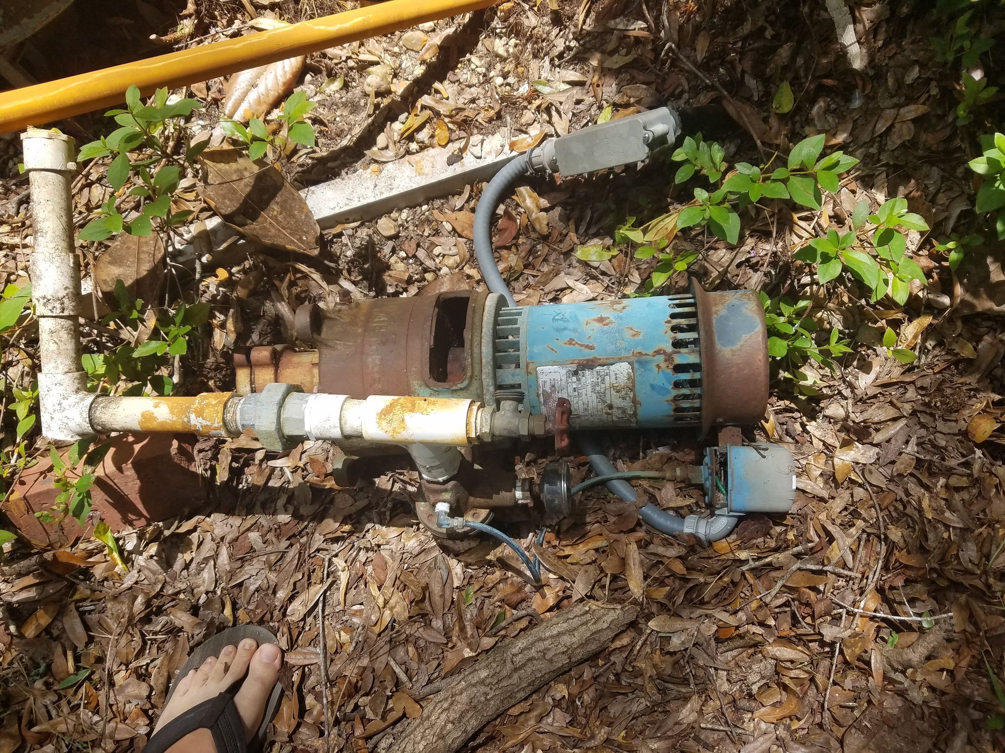

I own a house built in 84 in the southeast on the gulf coast, and previous owner had either a well put in or did it himself. My backyard has a creek at the backside of it so close to water table. Pump never worked and neighbor "helped" me fix it by burning it up, as in literal smoke coming out of it. Original owner only had one sprinkler head running off of it. Here is what I discovered pulling everything out. Was using what appears to be a vertical Sta-Rite pump with pressure tank. The pump was mounted directly onto the PVC casing of the well. The casing of the well appears to be 2 inches. I am calling it a casing, but there was another pipe inside the 2" casing. This pipe is about 1.5 inches in diameter and approximately 25 feet in length made of multiple sections. It does NOT have what I think is referred to as a "well point" at the end. Instead the second to last section has this iron suction? piece in line with the next piece of PVC. I have never seen anything like it in watching every well video and reading every article I can find so not sure exactly how it worked. It is not a pump inside the well and there is not much to it. I will post pictures of all of this:

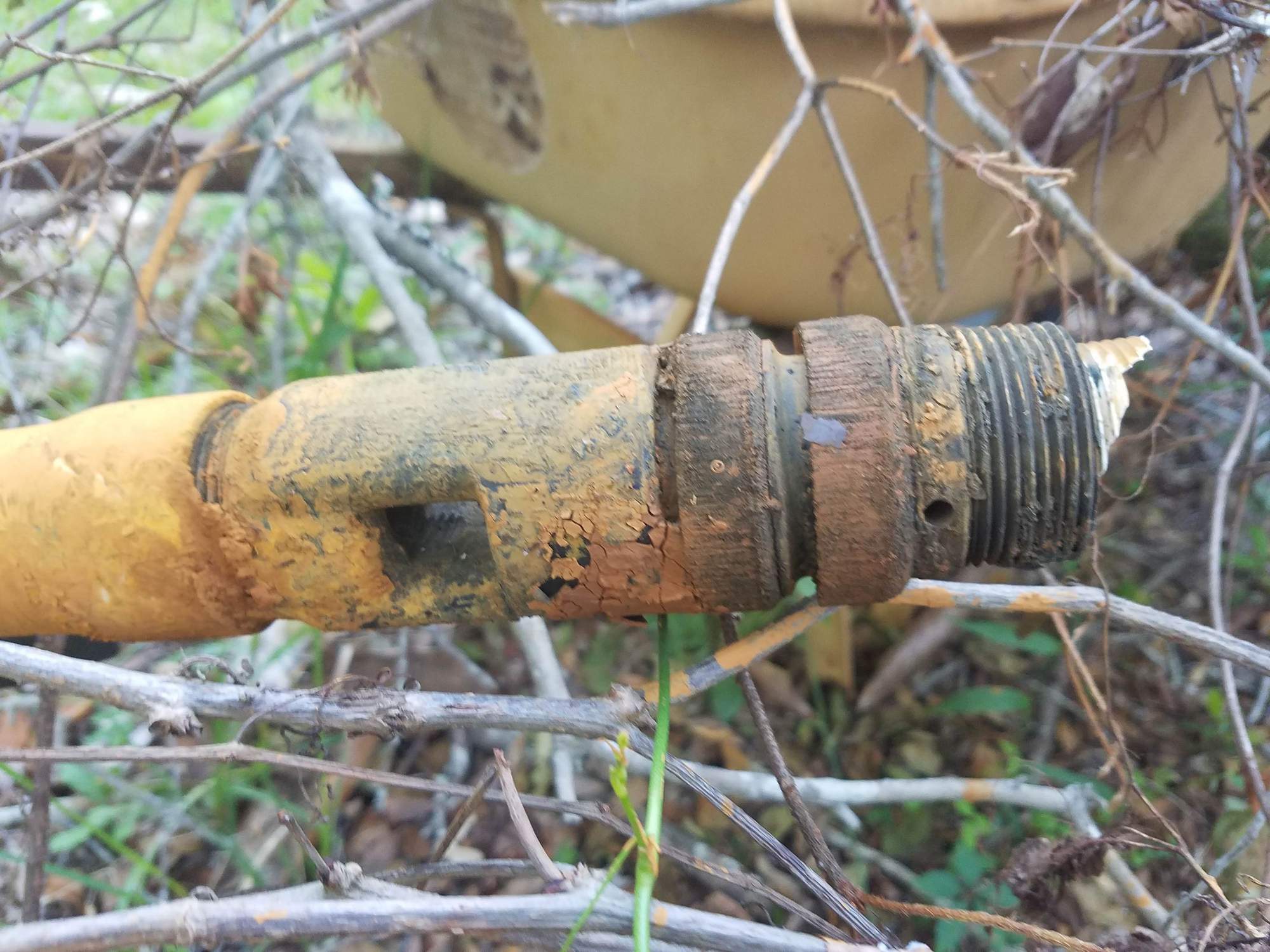

Strange iron piece almost at end of 25' pvc pipe inside casing. This piece was not at the end but the next to last section of PVC. The very end piece broke off of it removing it from casing
Here are several pictures of the pump. While the pump is on its side it was originally standing upright vertical on top of the well casing.
Here is the underside of the pump that was sitting on top of the casing. You can see the small pipe broken off inside.
Finally here are shots of the well along with the longer inner piece of PVC I pulled from the casing:

I don't see a foot valve anywhere. I'm hoping that isn't what broke off down in the well. The foot valve is a check valve at the bottom of the well string that traps the water in the vertical pipe & pump when the pump is not running and maintains the pump's prime.
You have a well casing that has a perforated pipe that allows water to enter and the supply pipe which goes inside the casing to suck water from the well. The pressure tank is nothing more than your own personal storage tank so when you open a valve the pressure doesn't instantly drop to zero.
As Dane mentioned you need a foot valve at the bottom of the suction pipe to prevent the pump from losing prime when it shuts off.
What you have is likely better than what you will get with a well point. I would start by pushing something down the well to see how deep it is and also to see where the water level is. Then you will know how much suction pipe with a foot valve you need to drop down the well.
Obviously I would like to size a pump that could run the sprinkler as well as still run that one or two faucets in the back of the yard.
It's not only what you want to run. It's what is the well capable of delivering without constantly running dry. Typically in a shallow well setup a 3/4 HP pump would be a good choice. Pressure tanks aren't always required in irrigation systems. A pressure tank is there to keep the motor from constantly starting and stopping. Ideally you want to match the pumps output to the sprinklers demand. If you want the system to stay charged for faucets.... then a tank is needed.
That may be a foot valve in your first picture. If you're in a sandy area..... the point will be purposely kept off the bottom so as not to pick up sand.
If you have any neighbors with a similar system.. see what they use.
Apparently the mystery piece in my first picture is some style of foot valve as I have seen others although they seem to be used in "deep wells". Here is one example:
The piece that broke off was nothing more than about another foot of plain PVC with a cap on the bottom. I don't know if this is keep the valve at a certain level in the water?
