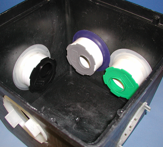

If you have wetness at the end of the first lateral I would inspect the distribution box. Gravity system distribution boxes are very sensitive to being out of level which can send all or more of the flow to one lateral instead of evenly distributing among them all. If you find that yours is out of level you can dig the whole thing up and re-level or there are some easier options.
One option is plastic disks that you pound/push into the outlet pipes. They have a hole that is off center. Instead of leveling the box you rotate the plastic to get the drain hole to the needed elevation.
There are also V shaped plastic wiers that go on each of the outlet pipes. The tall, thin V design greatly minimizes the affect being out of level has on the effluent flow. Some, like in this photos, have an adjustable height dam so you can adjust the flow after they are installed.
