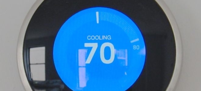

A thermostat.
Wiring a central heating thermostat is a straightforward task but requires caution, research, and the proper equipment. HVAC wires are generally color coded, but unfortunately not all manufacturers or installers follow the same codes. Connecting wires in the wrong manner can damage your system’s components and easily triple the cost of the repairs you were trying to make. Always follow proper safety procedures when working with electrical wiring. Follow these tips.
