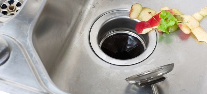

food in a sink over a garbage disposal drain

Although these issues may be fixable, you undoubtedly want to avoid having them in the first place. Do so by avoiding running fibrous foods such as coffee grounds, eggshells, bones, glass, rubber, or metal in your disposal. Also be careful to never overfill the disposal and avoid using chemical drain cleaners on it.
Whenever you’re using your disposal, run cold water and use a drain strainer to avoid clogs and debris buildup in the pipe.
