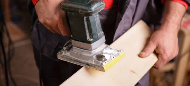

3 Common Sander Problems
man using a sander to sand the edge of a board
Common sander problems can easily creep up--especially on older models. Many newer models are designed with self-correcting features that plagued older versions. But, at some point, you may need to replace a part or make repairs. You may need to be a little mechanically inclined, especially if it is a motor problem but other problems may be solved with routine maintenance.
