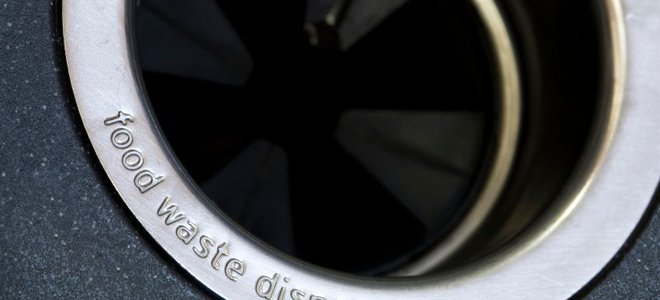

1. Sink Flange
The uppermost portion of the garbage disposal is a sink flange. This is the part where the disposal meets the sink drain. It can leak from a for different reasons.
Firstly, the mounting bolts that secure it in place may not be tight enough. There are three of them, and they should all be tightened securely.
Another reason could be that the plumber's putty has failed. In order to replace the putty, you will need to loosen the retaining bolts. Once you've created a gap, force some new putty in between the flange and the pipe. Then re-tighten the bolts to hold the putty in place.
