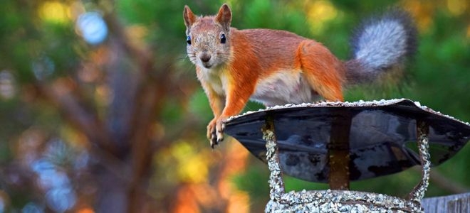

There are a variety of chimney cowls featuring a broad spectrum of applications and uses. Chimney cowls are also known as chimney caps and are referred to as cowls due to their overall shape being reminiscent of a monk's robe, or cowl. Cowls serve to prevent strong winds driving the smoke escaping up the flue back down into the room of the heating appliance, filling the room with toxic gasses and soot. Cowls also prevent birds and small animals from nesting in the chimney. Many cowls are multipurpose and can help to address all of these issues. Some cowls are specifically made for one particular purpose. Check the product information on the cowl before you buy to make sure it is suitable for the needs of your particular home, weather conditions common in your area, and fuel that will be used. Below you will find descriptions of different types of cowls and their uses.
