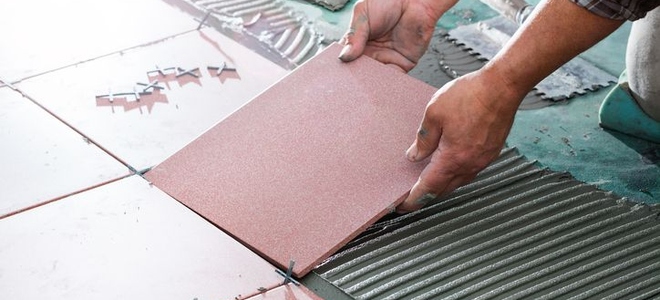

1. Tile a Floor
One skill you can learn this year that will save you a lot of money if you do it yourself is tiling. Laying tile on a floor or wall isn't that hard to do—it just looks intimidating. Many home improvement stores like Home Depot even have free classes on how to do it. Most of the tools you'll need you likely already have, such as a putty knife, trowel, and a level. The only thing you may not have is a tile cutter, which you can just rent on a project by project basis if you don't want to invest in one. To lay tile, you basically spread mastic onto a floor or wall with a trowel, set the tile on top of it (cutting it if necessary), check to make sure it's level, and then finish up by applying the grout over the top. It's truly that easy.
