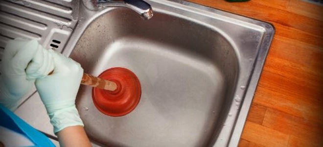

Using a sink plunger on a clogged drain.

3 - Your Drain Just Clogged
Of course it did. Plumbers love the holidays. You are cooking constantly and probably shoving way too much grease and food remains down the sink or disposal. If your have drain opener handy, follow the instructions. However, try these tricks first to clear the drain safely.
Step 1 - Use a small bucket and get rid of any standing water and solid debris. If possible, get dispose it outside, not down another sink.
Step 2 - Try a plunger. Do try a plunger first to see if you can clear the clog. Remember two things: Do not use a plunger if you have used drain opener. Cover any attached drains.
For example, with a dual sink, you must cover the drain on the other side or the water will just shoot out at you.
Step 3 - Try baking soda and vinegar. Pour ½ cup of baking soda into the drain. Follow with 2 cups of white vinegar. This mixture should create a foamy, noisy chemical reaction; however, it is completely safe. You may have to repeat the process a second time. Once the drain is clear, flush it with some boiling water to make sure everything moves out of your home’s drainage system.
