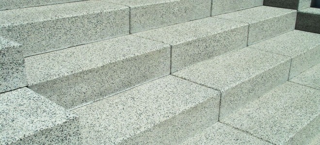

Staining concrete pavers can transform them from dull, solid color tones to personalized designs in bright, vibrant hues. Concrete stains are available in both acid-based and water-based dyes. Water-based concrete stains are the simplest and easiest dyes to use. Follow the simple steps below to effectively create your own concrete paver stain at home, in colors of your own choosing.
Step 1 – Choosing Your Concrete Pavers
Visit your local landscaping or home improvement store to purchase your pavers. Choose the shape and size of paver you want to install. You may decide to choose pieces in various shapes and sizes in order to create your own design pattern. Be sure to choose pavers in neutral tones. Neutral tones are the easiest ones for covering with stain. You will need to be sure you purchase enough pavers for your entire landscaping project.
