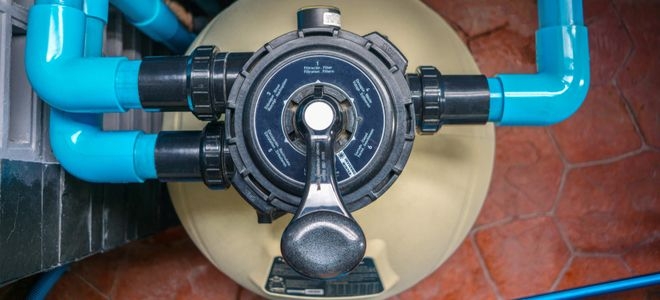

A pool sand filter with blue pipes from above

If your water has visible debris in it, check the filter for dirt. You can also look at the reading on the pressure gauge. If you can see dirt in the filter or the gauge reads eight to 10 pounds above clean levels, it's time to backwash your filter. This means you will flush water through the filter in the opposite direction. The process will release trapped dirt and send it out through the waste line. Use the multiport valve or the push-pull valve to reverse the flow of water through the sand filter and backwash it.
