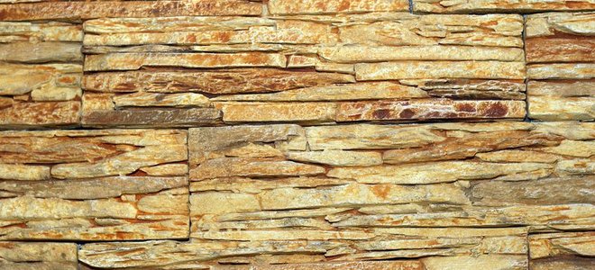

A stone veneer fireplace is a simple way to add drama and old world elegance to your fireplace. Stone veneer doesn't look much different than real stone, and when installed correctly, most people will be unable to tell the difference. A veneer surround is relatively simple to install on your own, and should take a weekend at the most to complete.

Lay your drop cloth in an area where you will have plenty of room to work. Lay the stone veneer out on the drop cloth in the pattern you are wanting to create the fireplace surround. Play around with this until you have a template you like. Use the masonry drill with a grinder to score the back sides of the corner pieces. You may have to remove excess material on the corner pieces to get an accurate fit. A brick hammer can be used to do this.
