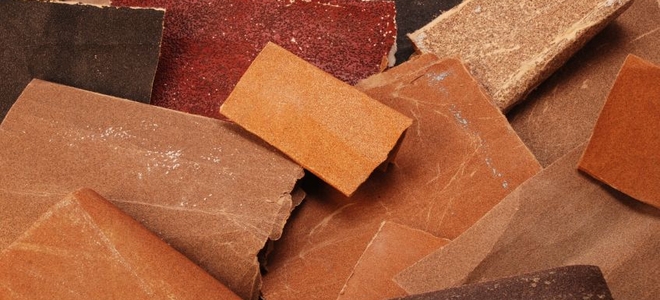

A Complete Guide to Sandpaper Grit Classification
A sandpaper's grit refers to the size of the abrasive materials on the paper. There are various standards that exist for ascertaining sandpaper grit size, but common standards include the Coated Abrasive Manufacturers Institute (CAMI) and the Federation of European Producers of Abrasives (FEPA). Regardless of which standard you use to measure, a general rule is that the lower the number of the sandpaper grit, the coarser the grit grade will be.
