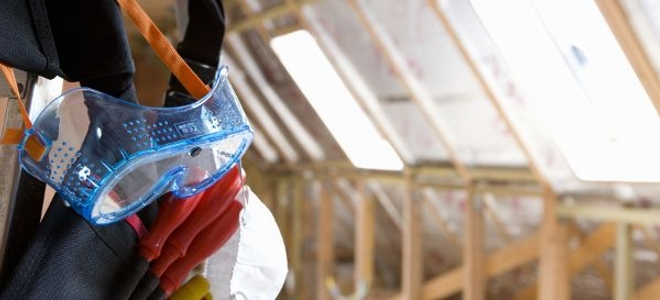

For most homes, an attic is a place for storage. But what if that space can also, if left to its own accord, be a determent to the rest of the home? Experts claim that routine inspections and maintenance at least once per season are needed to ensure the spaces’ longevity and safety, as it is the closest space to the roof and a barrier to the rest of the house and can quickly pose danger if certain things go unnoticed. This article offers tips and suggestions to create a routine of simple yet necessary checks of a home’s attic space.

A homeowner should first enter an attic in the daylight. During the day, look for streams of light through cracks and crevices, taking time to fill such holes as necessary. Caused by elements (high winds for instance), or even the age and building materials of the home itself, any lesions or cracks can lead to bigger issues down the road as moisture and non-controlled temperature can run rampant in the unregulated space. Further, this check-up is imperative as such occurrences can too be symptoms of issues elsewhere in the home such as foundation and structural issues, stress and deterioration of load-bearing walls, even decay of wood and fabrication materials in the attic itself.
