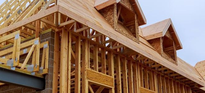

framed house under construction
In wood frame construction, house framing involves the erection of the wood frame’s structural components (studs, rafters, joists) onto which sheetrock, sheathing, roofing, and exterior cladding will be installed. Framing is a critical part of the construction process and requires a certain amount of skill. Knowing when to do it yourself or hire the services of a professional is key to the success of your project.

Layout and Frame the Walls
framed walls of a house under construction
First, mark the layout of the floor plan onto either a concrete slab or plywood decking with a chalk line. These lines give the exact location of the bottom plate of the walls to be erected. The walls consist of a two by four top plate and bottom plate and two by four studs at 16 inches on center. Each wall is constructed separately with the rough window and door openings in the appropriate locations, and laid out flat in position. They are then tilted upright into place, made plumb, and nailed together.

Install the Ridge Board and Roof Rafters
Rafters of a home
Rafters also vary in size from 2 x 6 inches to 2 x 12 inches and are cut and assembled to form a wide variety of roof configurations (gabled, hip, and shed roofs are a few common types). Install the ridge board (typically 2 x 12) first, setting it up on posts and making level. Then nail the pre-cut rafters in place at the ridge and at the plate. The notched lower ends of the rafters sit on the top plates alongside each joist and usually extend past the exterior wall to provide an overhang. The top end of each rafter is connected to the ridge board to form the roof peak. The angle of the cut at the ridge end and at the notch will determine the pitch of the roof. A roof that slopes upward vertically six inches for every 12 inches measured horizontally is said to have a six-inch pitch. The studs, joists and rafters are all at 16 inches on center and should be made to align so that a continuous load path will be directed into the ground.
