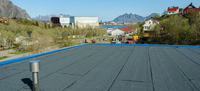

If you are considering building a home or other edifice with a flat roof and live in an area where there is snow during the winter, you must calculate the capacity of the roof for snowfall and other roof loading variables. Unlike sloped roofs that allow snow and other buildups to fall to the ground, flat roofs tend to collect snow and other debris. In cold climates, an entire season’s worth of snow may accumulate on a flat roof without any melting or evaporation. For this reason, it is crucial that your flat roof be able to support the weight of the snow, not only for the structural integrity of the building but also for the safety of people in and around the building.
