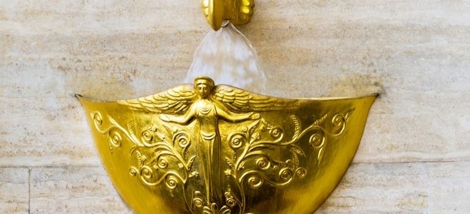

If you are looking to capture some of the breezy outdoors in your home, adding an indoor waterfall is just the thing. An indoor fountain will also give any room an aesthetic focal point, incorporating modern design with a typical outdoor feature. When installing an indoor waterfall fountain, you have the choice between buying one that is already made and building it yourself. Indoor waterfalls come in a variety of materials including slate, copper, marble and stone. If you are looking for a low cost, simple waterfall, then building it yourself is the best option.
