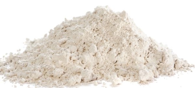

A small pile of DE (diatomaceous earth) powder.

A DE pool filter is used for cleaning the water in a swimming pool by removing accumulated debris. A DE filter is different from conventional sand and cartridge-based filters. It uses a special ingredient called DE powder, which stands for "diatomaceous earth." DE is commonly sold at pool supply stores in the form of a coarse white powder. It is actually a form of ground up algae fossils that is retrieved from the bottom of deep lakes, and is also used in gardening, construction, and numerous other applications.
