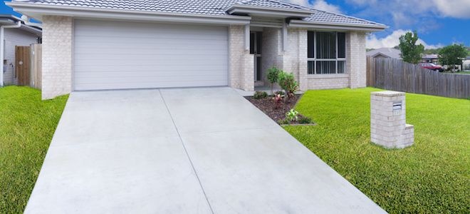

After years of useful abuse, your old cement driveway could probably use a facelift. Once you have decided to tackle the project, gather the right tools and materials and then follow these multi-task directions to add some curb appeal to your neighborhood eyesore.
Surface Preparation
Step 1 - Check the Heights
Your garage floor needs to match the level of the stone layer added to the driveway. If necessary, build up your concrete floor lip by acquiring a small amount of either asphalt or concrete.
Step 2 - Add a Border
Before working on the driveway surface area, run a line on both sides using string. Make sure these are straight and then use as guides for laying rock for the driveway borders.
Step 3 - Apply Adhesive
Make sure the surface area is clean and then apply construction adhesive for the first row of rock. Make sure to secure the border rock with adhesive, also.
