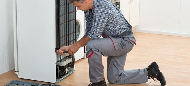

Busted Fridge
There are many reasons why a refrigerator stops working properly, but a few of the more common problems are easy to diagnose and fix. For starters, check the temperature dial inside the unit and make sure it is set to the right temperature. It is not uncommon for someone in the house to accidentally bump the dial and push it to a higher setting. If that is not the issue, check the cooling coils and make sure they are clean of dirt and debris. Pet hair can easily get inside the coils and prevent them from working properly. To fix it, simply remove the grille in front of the coils and vacuum everything out.
